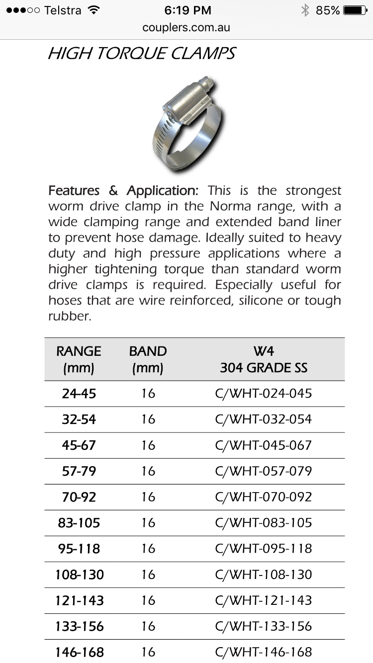

MBAF Legacy Donating Member 2,156 Member For: 10y 1m 4d Posted 09/10/16 09:57 AM Posted 09/10/16 09:57 AM Done that...still manages to pop off...ill persevere until I decide to change it 1
Puffwagon Legacy Donating Member 16,348 Member For: 11y 7m 21d Gender: Not Telling Posted 09/10/16 10:08 AM Posted 09/10/16 10:08 AM I've run north of 30 psi on just clamps and beads. There is obviously an issue with assembly or components. 1
arronm Dropping a turd Legacy Donating Member 9,520 Member For: 18y 10m 23d Gender: Male Location: Perth Posted 09/10/16 10:24 AM Posted 09/10/16 10:24 AM I use these the trick is tighten adjacent the the lip 2
