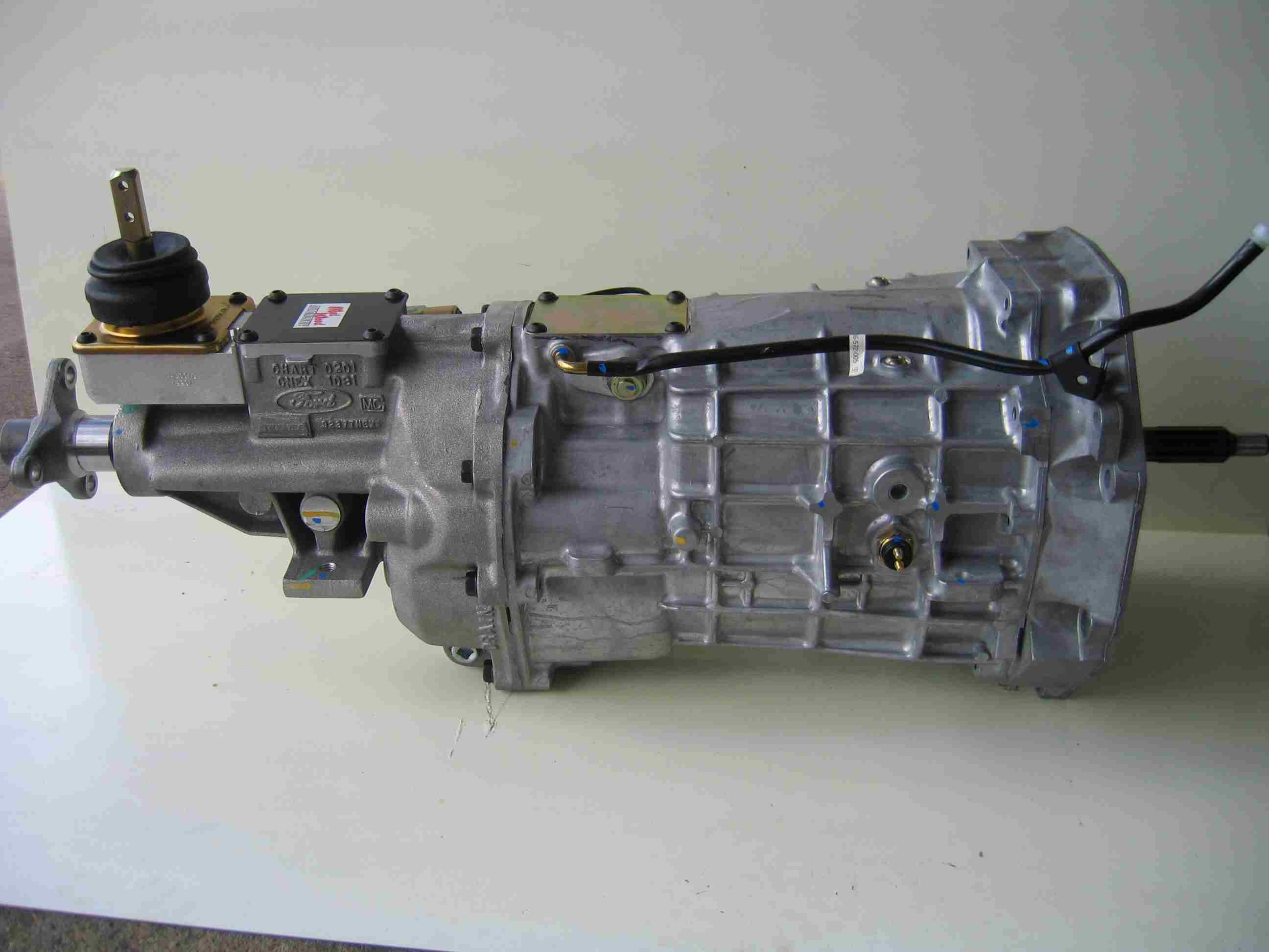

Gearbox.
Now that my 6-speed gearbox thread is back (although most of you have probably read about it), for completeness I'll provide the link.
It's http://www.fordxr6turbo.com/forum/index.php?showtopic=9148
The T56 gears are substantially bigger and stronger than the T5, to handle substantially more torque.
Gear ratios are as follows: 2.97 2.07 1.43 1 0.80 0.62
Brian

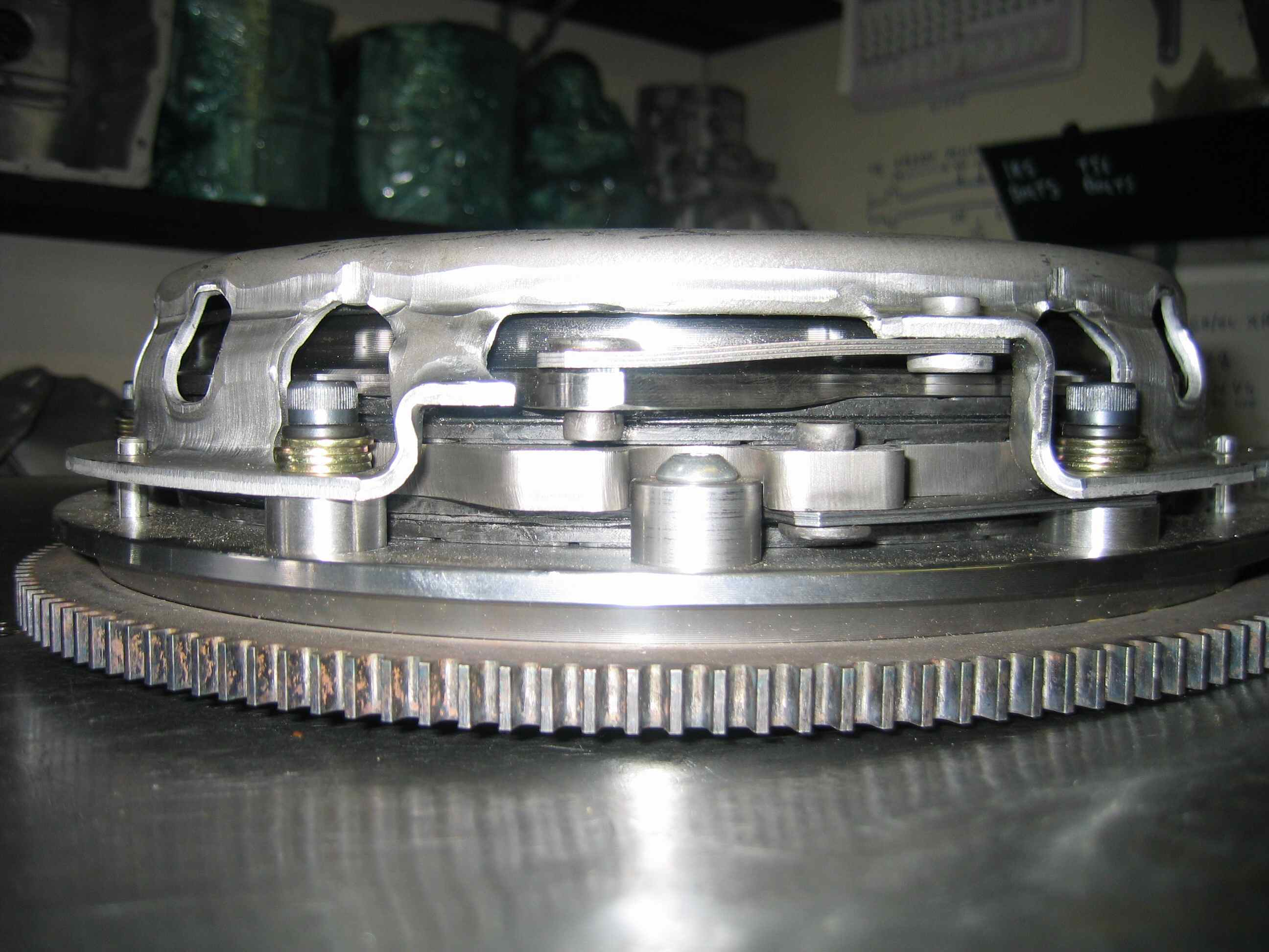

Here's the twin-plate clutch from Mal Wood auto, that should handle around 1100NM of torque. This is a very smooth clutch to drive with, with about 10% extra foot pedal pressure over standard.
For me this is a much better option than a single plate clutch that has around 50% extra pedal effort, or driving with a clutch that shudders.
More expensive, yes, but I want to enjoy my driving.
Brian

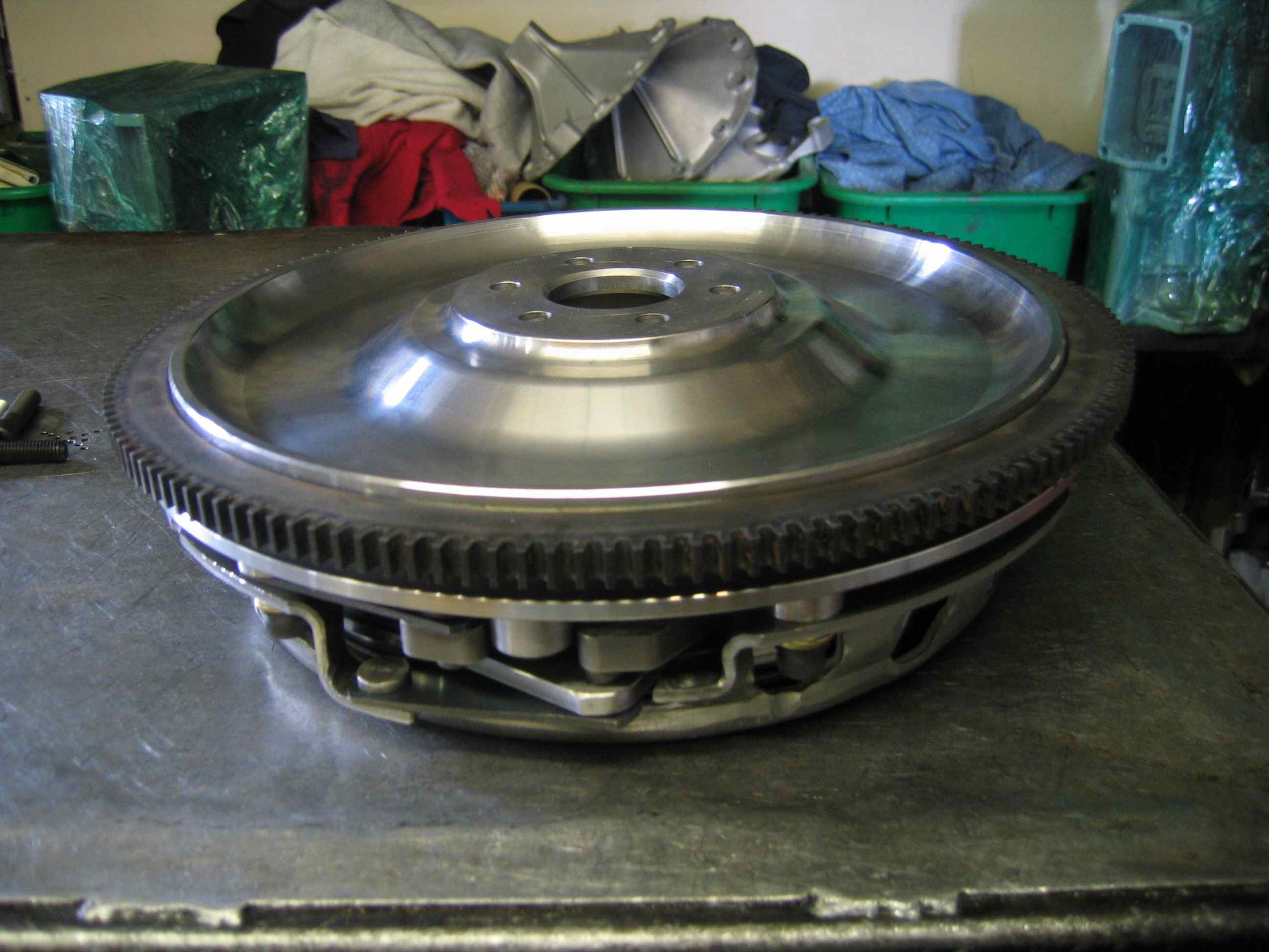

Here's a different shot of the steel flywheel.
The steel flywheel is far stronger than the OE version. After removal the OE item was found to be warped by 1-2mm.
Brian
