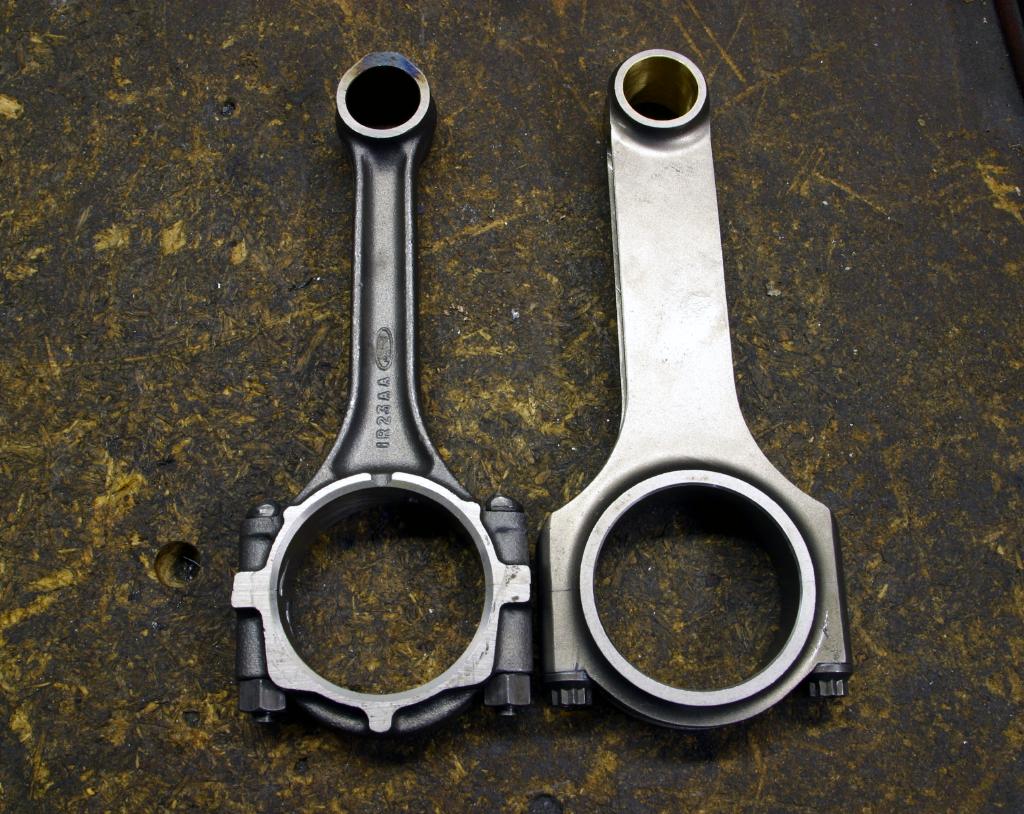

Here's a pic of the new rod compared to the old rod.
Wow Brian, that's a big difference. Who makes the new rod and out of what? What would a set of rods like that cost. How much would it cost to fit them and what else would you change at the same time while the engine is pulled down?

Geea,
Yes, substantially larger and stronger.
You'd have to ask Simon at Nizpro for more details, including cost.
These are used as part of the Nizpro stage 3 kit, and this is recommended by them for 330rwkw+ engines. I did valve springs, rods and pistons at the same time, helping to reduce costs and give me more future power upgrade potential.
