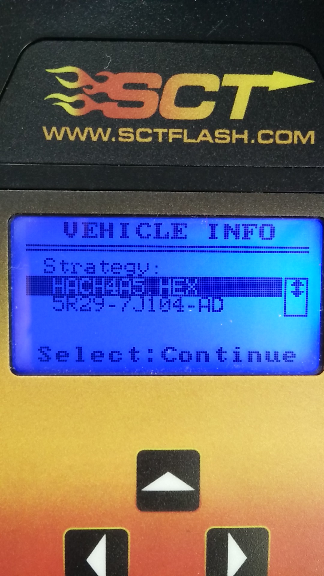

bjc Legacy Donating Member 2,823 Member For: 23y 13d Gender: Male Location: Townsville Posted 14/06/15 08:37 AM Posted 14/06/15 08:37 AM Did that and what a cnt of a job stealing it from the printer! Grrr... Does this photo below mean anything to anyone?I'm loading the tune back in my car now as I've given up.In another note... Can the tuner update the Xcal3 without returning it to stock as I'll send it to Dave if he can? Main reason was to get a ZF tune of him to see if that gearbox whine either goes or gets quieter with a former soft as it's out of control atm! I originally thought it had milkshaked as it went from happening in 3-4 only to every gear and any throttle except full throttle...
CHLAXN Legacy Donating Member 932 Member For: 18y 3m 26d Gender: Male Location: north QLD Posted 14/06/15 09:17 AM Posted 14/06/15 09:17 AM (edited) Has to be turned to stock before update. Dave had dramas trying to update mine a while back when I was there for a tune. Ended up having to buy another one there and then to get car tuned as our days off did not align up for ages after lol.. Kept spare x3 for the F6 Edited 14/06/15 09:18 AM by CHLAXN

bjc Legacy Donating Member 2,823 Member For: 23y 13d Gender: Male Location: Townsville Posted 14/06/15 11:45 AM Posted 14/06/15 11:45 AM Has to be turned to stock before update. Dave had dramas trying to update mine a while back when I was there for a tune. Ended up having to buy another one there and then to get car tuned as our days off did not align up for ages after lol.. Kept spare x3 for the F6Yeh I was hoping owners of the software could pull a dodgy or something but obviously not! Painful...
discostig Manual mode ________________________ All day, erryday Legacy Donating Member 13,798 Member For: 18y 9m 24d Gender: Male Location: Probably above atmospheric pressure Posted 14/06/15 11:57 AM Posted 14/06/15 11:57 AM XFT had a hell of a time getting mine updated when I got a retune with valve springs a couple years ago. Mine was one of the first version of XCAL3 released and I recall Simon saying there was a big fck around getting it updated. Returning to stock and then some other drama. Good luck!
Serangan Member 103 Member For: 12y 11m 26d Gender: Male Location: Hobart, Tasmania Posted 14/06/15 12:24 PM Posted 14/06/15 12:24 PM Seems to be same drama for the xcal4. mine had to be updated and its kicking up a fuss about it.
