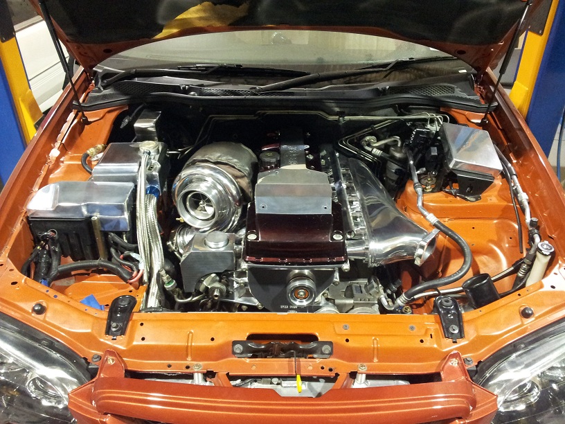

qik1 Legacy Donating Member 2,720 Member For: 18y 4m 8d Gender: Male Location: Loitering in SEQ Posted 30/06/12 10:39 AM Author Posted 30/06/12 10:39 AM (edited) none your honour.Pics of todays progress. We're still abit from being 100% complete plus new air brushing, covers & blong to come yet so dont judge it just yet So much thanks has to go out to Jamie at Forced Performance for taking a day out of his wkend to get it this far & and kade from 6boost for lending his skills with the welder & spare set of hands. A build like this doesnt happen without good friends, people who love these vechiles & and an understanding wife and im so lucky to have all of the above. Thanks to all those invoved in getting us this far so fast Edited 25/04/13 02:31 AM by Dagabond
