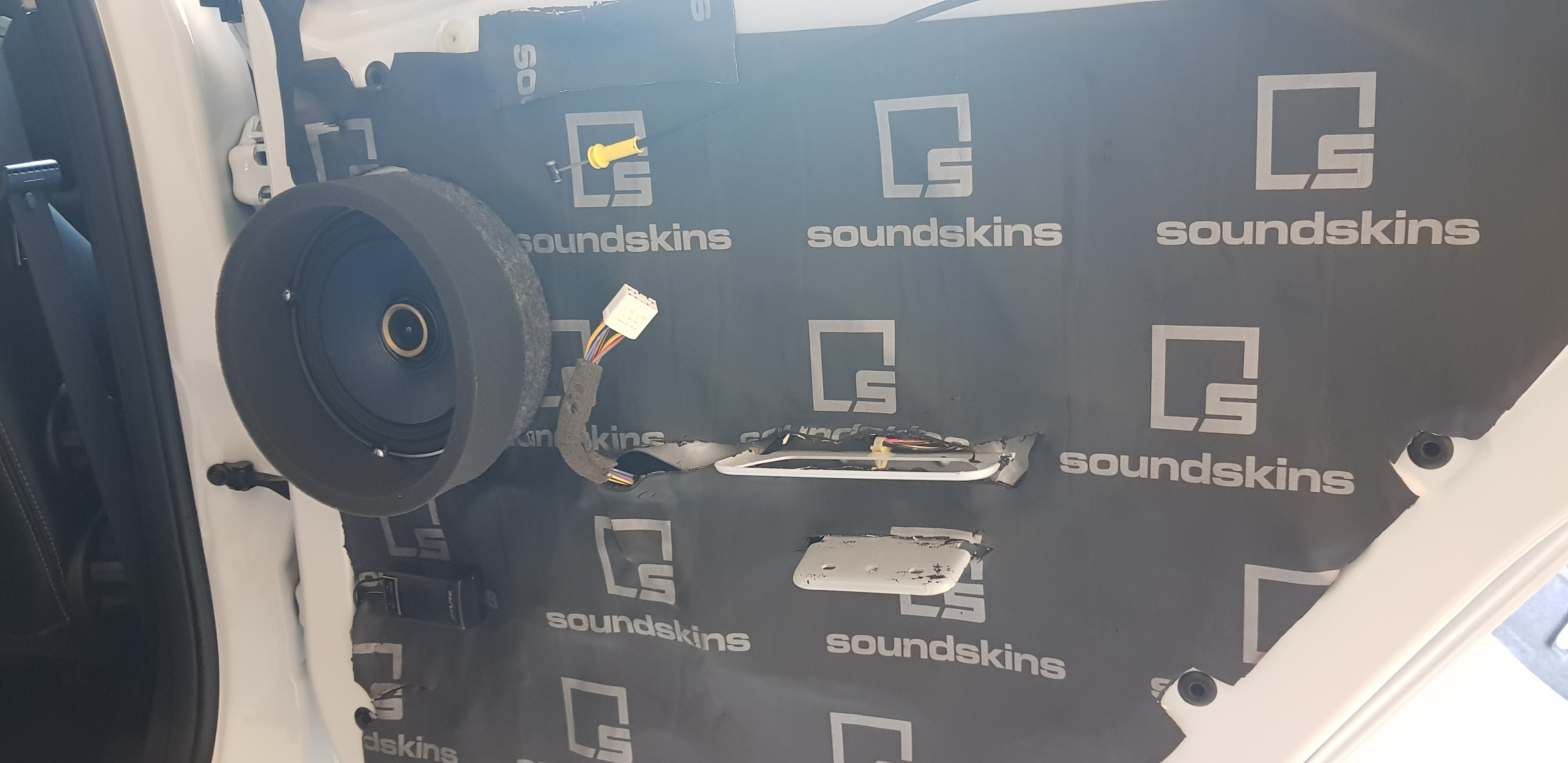

Boog72 Legacy Donating Member 107 Member For: 18y 2m 14d Gender: Male Location: Brisbane, Qld Posted 20/01/19 04:44 PM Posted 20/01/19 04:44 PM Heres pics of some parts of the install in my rspec The soundskins made a huge difference to the sound quality. I also used the spacers from supercheap just to get the speakers off the door with the stinger rings and backing pad behind the speakers attached to the soundskins on the inner door panel. I ended up biffing the kicker cx 300.4 and 600.1 went with the Alpine X series A70F and A70M mono amp to keep it all alpine. The Rockford DSR1 unit has been awesome and the sound is clear and doing the job. 1
