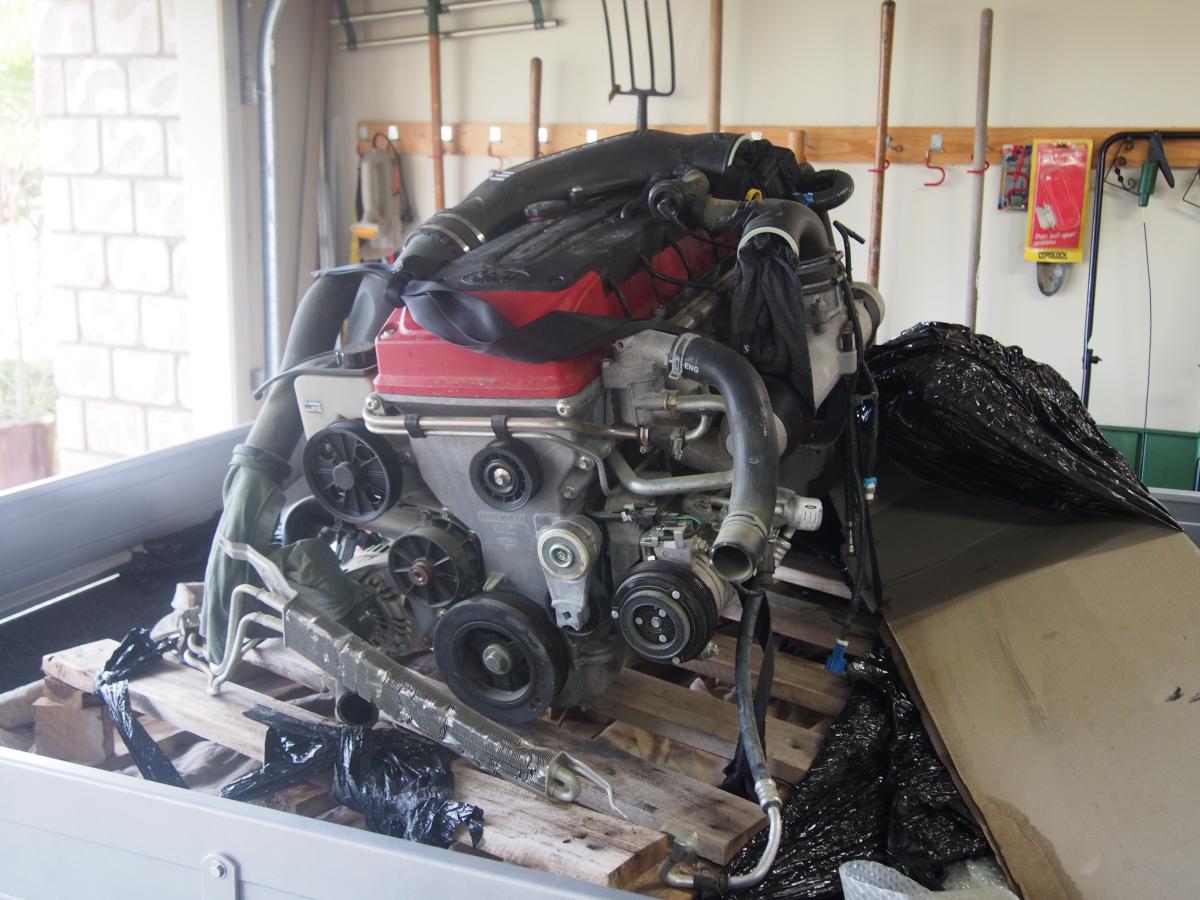

genuine honest person Member 2,769 Member For: 12y 7m 28d Gender: Male Location: near brisbane Posted 07/04/15 08:50 AM Author Posted 07/04/15 08:50 AM sorry stripes , all I have to do is klick on the photo to enlarge it . am I the only one that can do that ?.the engine has arrived 5
Wilko16 Legacy Donating Member 1,672 Member For: 18y 10m 4d Gender: Male Location: Melbourne Posted 07/04/15 08:57 AM Posted 07/04/15 08:57 AM Awesome that you picked up in the car it's going into [emoji106][emoji106][emoji106] 3
genuine honest person Member 2,769 Member For: 12y 7m 28d Gender: Male Location: near brisbane Posted 07/04/15 10:00 AM Author Posted 07/04/15 10:00 AM had to only pick it up from work ,had to take it slow ,because of the loose flex plate . got it home ok . building the engine stand at the moment ,got to get some bolts to suit the engine . I had some from the last build but am unable to find one of them ,have all 3 of them bugger

.Stripes. All stock bar the k&n panel filter Legacy Donating Member 8,061 Member For: 14y 6m 12d Gender: Male Location: Perth Posted 07/04/15 10:29 AM Posted 07/04/15 10:29 AM sorry stripes , all I have to do is klick on the photo to enlarge it . am I the only one that can do that ?.the engine has arrivedHaha sorry bud, that was me being facetious about old mates spelling and grammar [emoji12] Exciting times with the engine turning up though. Looking forward to seeing the skids this thing rips when it's done! 1
genuine honest person Member 2,769 Member For: 12y 7m 28d Gender: Male Location: near brisbane Posted 07/04/15 11:25 AM Author Posted 07/04/15 11:25 AM (edited) stripes so do I , its just that it will take a lot of time for me to get it all back together . I looked at the engine and said why did I do this to my self lol .Bomber , I will give the T3 a go and the pads that you recommended (they are cheap enough to buy ) I also will run some high boil brake fluid from motul . I agree with you they are a big boat to stop ,with my little brakes . have had the same idea with the ducting for the brakes . on a friends race car he actually has a spray bottle ( electric window sprayer )hooked up to spray a mist every time he hits the brakes ,and he said it works greatcan tell the engine came from a panel shop ,all the bog dust is everywhere on the engine . have to get my compressor and air hose from work again Edited 07/04/15 11:28 AM by genuine honest person
