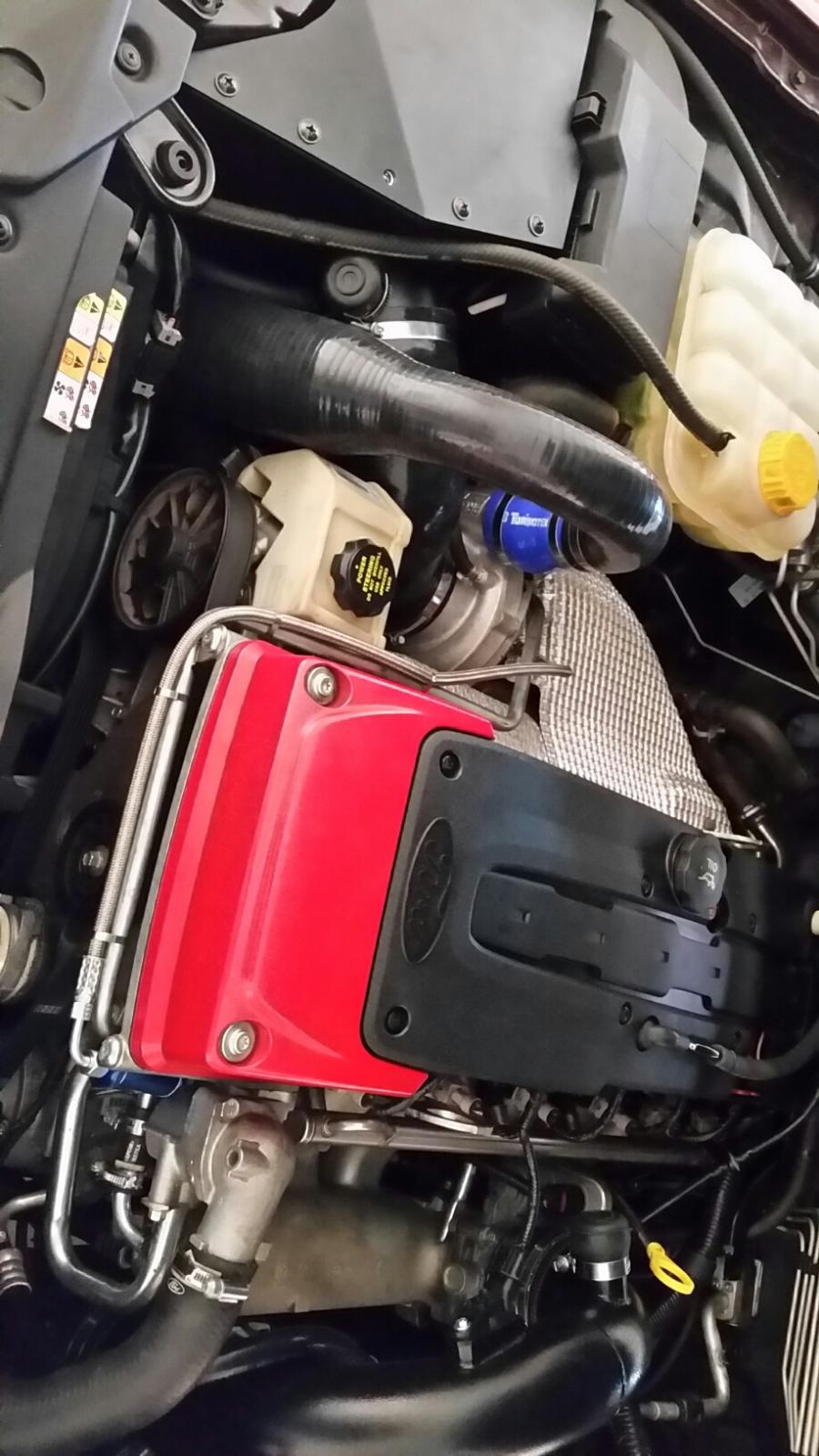

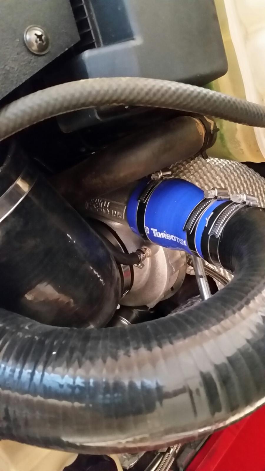

Buf-Phoon loitering with intent Lifetime Members 13,318 Member For: 21y 8m 21d Gender: Male Location: Zombie Birdhouse Posted 07/05/14 03:30 AM Share Posted 07/05/14 03:30 AM It doesn't feel much different to the stock one low down our not that I can tell and Simon said the same with the torque. I don't know all the technical stuff too much...what are AFR's,oh and while I'm asking I see WOT thrown around, what is that. Thanks. I'll upload a PIC of the turbo.AFRs = air fuel ratio ( lean /rich)WOT = wide open throttle Link to comment https://www.fordxr6turbo.com/forum/topic/87866-gtx3582-or-gtx3576-on-a-g6et/page/8/#findComment-1469996 Share on other sites More sharing options...

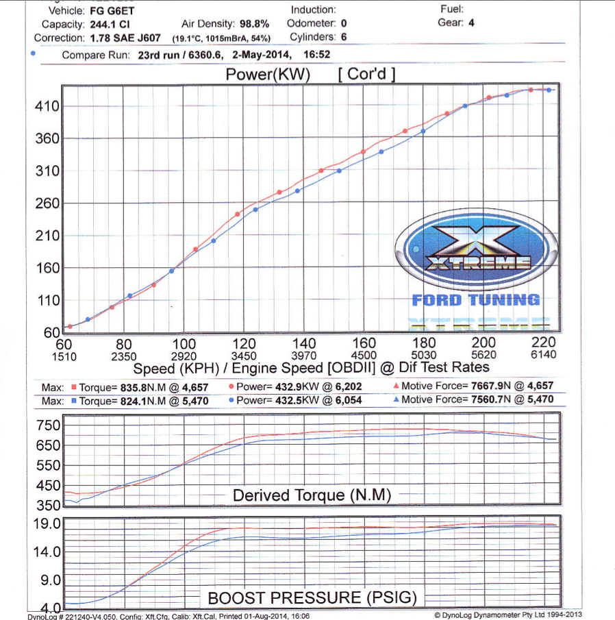

SeduceG6Et67 Member 67 Member For: 11y 3m 27d Gender: Male Location: Perth Posted 03/08/14 03:48 AM Share Posted 03/08/14 03:48 AM Hi guys,just a little update as to where the car is at with the PT6235. Car went in for a built ZF,trans cooler,over boost valve,Harrop truetrac-diff bushes and a strengthened driveshaft. The car made 432.9rwkw up from 423 with a little more in the mid range as well. Im hearing lots clunks and a bit of drone now which I'm not happy about but it seems common from reading other posts on diff bushes. The gear box on downshifts are not smooth,more noticeable when using manual mode. When I change down its like it goes into neutral then back into the selected gear. So if I'm at say 2500 revs the change down to 2nd as I'm slowing revs drop right down then back up to say 3000 which is very jerky and not nice. Its been like that for a few months since I had the new turbo and ZF tune,I thought the rebuild and retune would fix it. Simon is trying to sort it. Has anyone else experienced this. I will up load a pic of the dyno. Thanks in advance. 1 Link to comment https://www.fordxr6turbo.com/forum/topic/87866-gtx3582-or-gtx3576-on-a-g6et/page/8/#findComment-1489562 Share on other sites More sharing options...
SeduceG6Et67 Member 67 Member For: 11y 3m 27d Gender: Male Location: Perth Posted 03/08/14 04:22 AM Share Posted 03/08/14 04:22 AM This is on 98,not interested in E85. Link to comment https://www.fordxr6turbo.com/forum/topic/87866-gtx3582-or-gtx3576-on-a-g6et/page/8/#findComment-1489566 Share on other sites More sharing options...
Z2TT Member 714 Member For: 12y 11m 14d Posted 18/08/14 04:36 PM Share Posted 18/08/14 04:36 PM Yeah we can see how much punch the small turbo has from those 2 graphs, first comparison on the same car, same dyno I've seen.I enquired to Nizpro a while back, and they say they have a Turbo that will have the same power down low as the factory but make as much power as GTX3582r. Link to comment https://www.fordxr6turbo.com/forum/topic/87866-gtx3582-or-gtx3576-on-a-g6et/page/8/#findComment-1493394 Share on other sites More sharing options...
