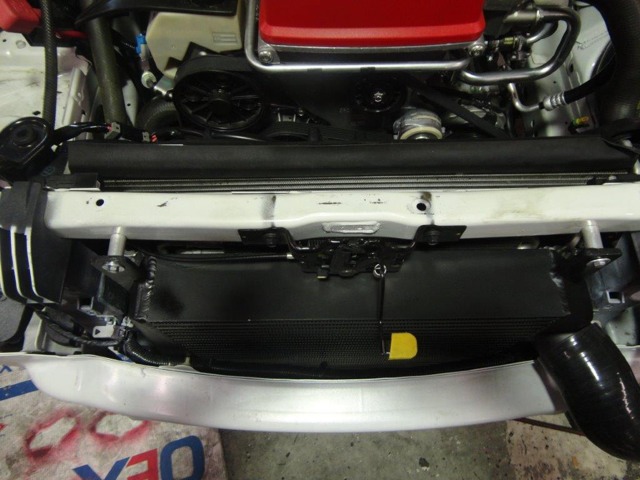

AdamIan69 Legacy Donating Member 401 Member For: 13y 5m 19d Gender: Male Location: WA Posted 17/07/13 01:18 AM Author Posted 17/07/13 01:18 AM (edited) You did mate, but I am happy to know it is still a good cooler. And I was always sceptical about the welding on the outlet pipe as was pointed out. And your right it did make my car a little more laggy, but nothing I am worrying about, and the gtx3582 will probably give me a touch more lag again. But I am happy, and nothing a 50hp shot of nitrous of the line won't sort out. Thanks for the feed back fellas and I'll try and get jimmixr pics up tonight.And I bought it off gum tree. Western AustraliaJimmixr's XR6 Nizpro Cooler Install.Looks good huh, and it looks as though there is no steel to be taken off around the outlet or for any hoses. But there has been two spacers put in for the upper mounts. Edited 18/07/13 04:47 AM by Dagabond 1

jimmixr Legacy Donating Member 686 Member For: 16y 1m 22d Posted 18/07/13 03:02 AM Posted 18/07/13 03:02 AM Little bit metal off the front crash bar.. 2x mounting holes drilled into the top supportAdam the 2x spacers are part of the kit... space it off the coolers in front of the radiator 1
AdamIan69 Legacy Donating Member 401 Member For: 13y 5m 19d Gender: Male Location: WA Posted 18/07/13 05:07 AM Author Posted 18/07/13 05:07 AM (edited) And you will still have to remove plastic for the cooler pipes to pass through the original holes.Where abouts are you G6ET, you could borrow the die grinder I bought for the job. Im in baldivis Edited 18/07/13 05:10 AM by AdamIan69

FORD G6ET Member 28 Member For: 13y 5m 21d Gender: Male Location: Melbourne Posted 18/07/13 12:38 PM Posted 18/07/13 12:38 PM I'm in Victoria pal but thanks for the offer. What about the front bar, easy to get of?
