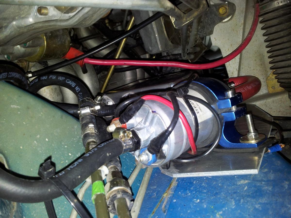

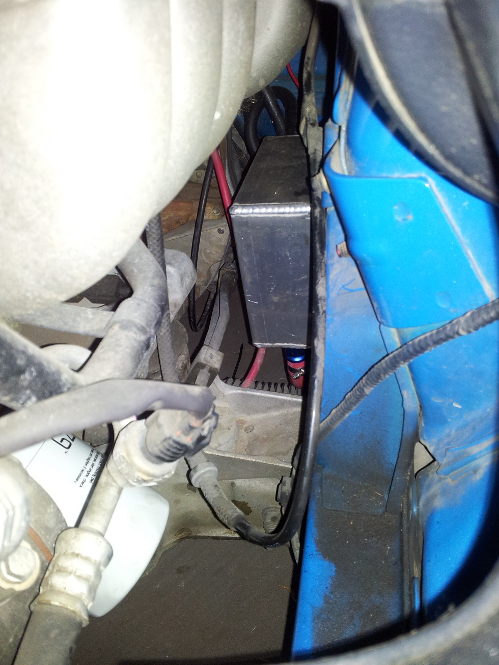

BAturb Member 521 Member For: 21y 10m 28d Gender: Male Location: Adelaide Posted 08/02/12 10:29 AM Posted 08/02/12 10:29 AM Yep just different bolts on the Plazmaman tank.I've talked about group buys with Alex a few times, main issue is there's not a huge mark up on these products anyway, so the lower group buy price may not be too impressive.At the end of the day, there's really no solid way to do the surge tank set up like these for much less... I've looked at doing my own at a lower cost, but by the time all the parts are added up its close to these two anyway... The only way to reduce price is use cheaper connections, hoses, pump ect... But there's no way I'm selling a cut price fuel system, seen too many fuel system leaks from poor quality hoses and fittings...I have a surge tank that I made up at work from 4mm aluminium, (cost me a cheesecake to have it welded,)I got an 044, all fittings (speedflow)fuel hose and clampsrelay, fuse holder and cablesfitted it myself in around an hour and 1/2total spend was around $300it is much cheaper if you really want to do it yourself

BAturb Member 521 Member For: 21y 10m 28d Gender: Male Location: Adelaide Posted 10/02/12 08:26 AM Posted 10/02/12 08:26 AM I mounted it in the same place as the PM and PW surge tanks
BAturb Member 521 Member For: 21y 10m 28d Gender: Male Location: Adelaide Posted 10/02/12 08:29 AM Posted 10/02/12 08:29 AM from under the car
