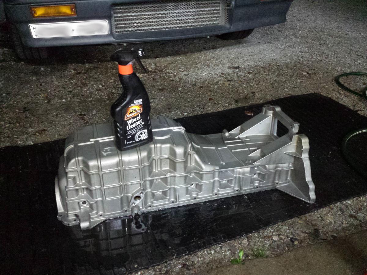

Pulled the sump off last night and was happy to find the missing piece of chain guide. I'm curious to know how long it's been down there.
post-49516-0-90083200-1409264990_thumb.j
Wheel cleaner works really well on aluminium, I figured the sump is basically a large mis-shaped alloy wheel :P
