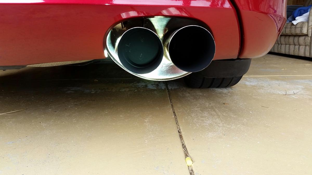

SeduceG6Et67 Member 67 Member For: 12y 8m 19d Gender: Male Location: Perth Posted 24/07/14 01:26 PM Posted 24/07/14 01:26 PM I got the Nizpro complete system,4 inch all the way twin cats and all stainless but wasn't happy with the drone. Sent it back to Nizpro(I'm in Perth) and had the bi modal thing installed. Under 5 pound its nice and quiet,light to med throttle and cruising its nice and quiet,stand on it and it opens up. More than $800 though but I thought I would share my experience.
turbotrana Member 2,586 Member For: 23y 6m 1d Gender: Male Posted 24/07/14 03:05 PM Posted 24/07/14 03:05 PM Can you put up pics of the Nizpro Bimodal bit
ratter Member 6,793 Member For: 20y 4m 5d Gender: Male Location: @ my laptop Posted 24/07/14 11:44 PM Posted 24/07/14 11:44 PM pretty sure bendoco has posted pics in his build thread of his when we modified it
SeduceG6Et67 Member 67 Member For: 12y 8m 19d Gender: Male Location: Perth Posted 25/07/14 12:43 PM Posted 25/07/14 12:43 PM (edited) You can't see the flap in the exhaust unless its really well lit and and you are really looking. The pic where you see the flap it has a torch shining on it. Edited 25/07/14 12:50 PM by SeduceG6Et67
BenDoCo I'm getten too old for this s**t Legacy Donating Member 4,509 Member For: 13y 5m 25d Gender: Male Location: A big bridge over a river in South Australia Posted 25/07/14 01:35 PM Posted 25/07/14 01:35 PM pretty sure bendoco has posted pics in his build thread of his when we modified itIn post 2http://www.fordxr6turbo.com/forum/topic/88536-the-bendoco-limo-long-lots-of-pics/page-1
