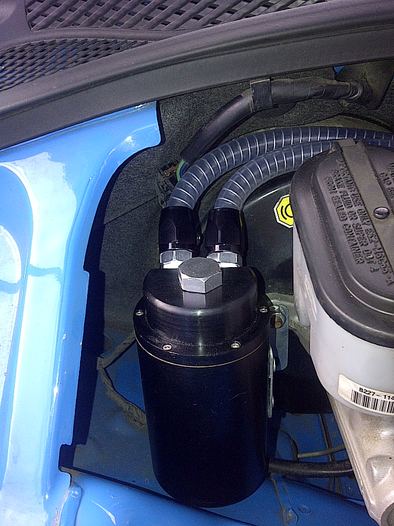

JGP Legacy Donating Member 309 Member For: 16y 1m 8d Gender: Male Posted 14/05/12 04:29 AM Posted 14/05/12 04:29 AM (edited) Update, here is a photo with my setup. I decided on the rear pcv circuit as it seems that is the major culprit after reading some threads. I also include the parts used for reference to anyone.hose used(10mm) http://www.mscn.com.au/scripts/prodView.asp?idproduct=501catch can used http://www.supercheapauto.com.au/online-store/products/Calibre-Oil-Catch-Can-Black-400cc-CALOCT04.aspx?pid=155180#Descriptionhttp://www.mscn.com.au/scripts/prodView.asp?idproduct=46 Edited 14/05/12 04:40 AM by JGP
