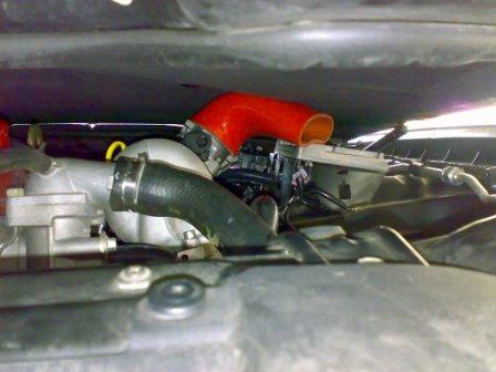

  5. Pics posted up in another "plenum" thread. I couldn't fit a 90 degree silicon elbow from the throttle body and still clear the computer or bonnet. Using a 90 degree pipe with flanges to place the throttle body more forward and on a different angle. Works real well - throttle response is brilliant. No extra power or torque on the dyno, AFR's and boost levels are the same - but the throttle response and driveability is heaps better.

  10. OK so here's some pix and info of fitting a DRIF6 style intake manifold. Purchased this top half of the plenum from a forum member. The std mount for the TB has been cut, reversed and tigged back into place. Here's what it looks like bolted on...and you can see how much (little) room there is to fit plumbing between the computer. Trying to fit a 90 degree silicon bend take up a fair bit of room... And closing the bonnet....forget about it, just hits the bend So the solution had to be a welded pipe to move the TB around. I think I might paint it in that textured black pain to make it look a bit more factory RESULTS : Didn't look like it gave any more power on the dyno (hard to tell when you've got a rooted auto and used 2 different dynos) but without changing tunes all the AFR's stayed in the same range and power & torque looked about the same. Driveability is a lot better though, the response time to throttle inputs is just magic. Another important fact on this is that all my piping from the turbo outlet to the intercooler is 65mm (that's the intake size on the intercooler) and all outlet piping is 70mm (that's the outlet size on the intercooler) right through to the throttle body. So we are taking advantage of all the large sizes to keep restrictions to a minimum.
