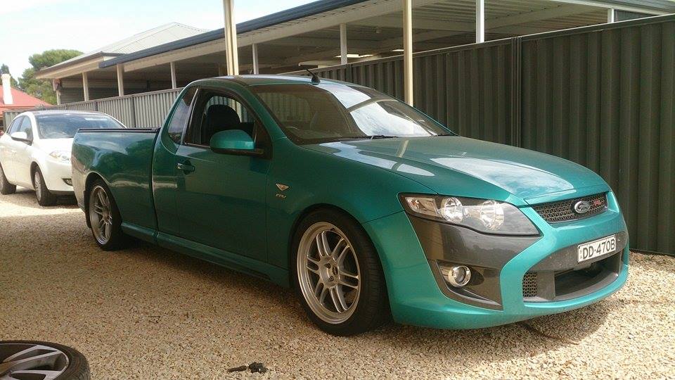

Luke S Member 4 Member For: 15y 12d Posted 14/02/15 12:47 PM Share Posted 14/02/15 12:47 PM Hi, I'm Luke, this is my first post. I've had my FG F6 for nearly 4 years now and I'd left it completely stock until now. I found a set of used Enkei's online for a good price, so here they areRear: 19x10 ET22Front: 19x8.5 ET22Current Tyres are what were on the rims when I bought them.275/35/19245/40/19This is a test fit for now, so I will put the correct tyres when I fit them up for good. 2 Link to comment https://www.fordxr6turbo.com/forum/topic/92946-fg-offsets-and-tyre-questions/page/267/#findComment-1530210 Share on other sites More sharing options...

PTR_NITRO_FG Donating Members 3,214 Member For: 11y 11m 24d Gender: Male Location: NOR Perth Posted 20/02/15 05:25 AM Share Posted 20/02/15 05:25 AM it would be 3.4mm LESS poke than the above rear pics from Luke S wtf is the point though? I upgraded rims to run larger rear tyres like 275 or 285 and 245 for front.Not your weird 225/245 combo....that would prob be less effective than standard rim setup? I'm guessing you've found some cheap jap rims or something....each to their own I suppose :/ Link to comment https://www.fordxr6turbo.com/forum/topic/92946-fg-offsets-and-tyre-questions/page/267/#findComment-1531267 Share on other sites More sharing options...
