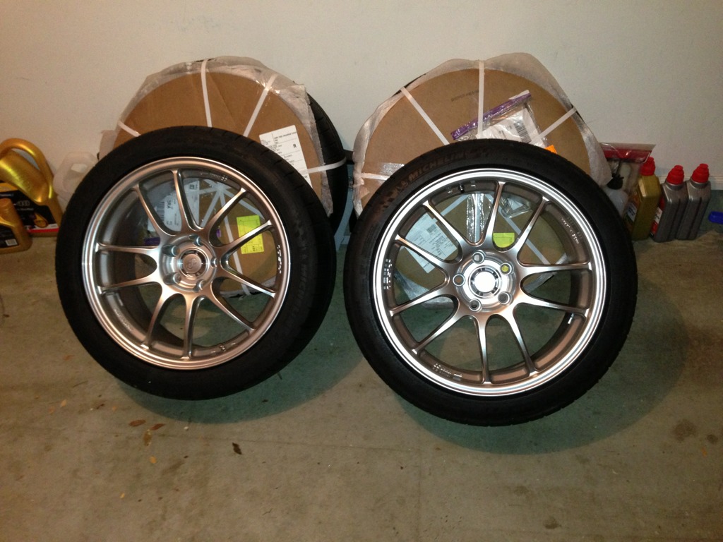

Bulletime Donating Members 937 Member For: 13y 8m 11d Gender: Male Posted 16/07/13 09:32 AM Share Posted 16/07/13 09:32 AM Sexy F6 there, very nice!So before I pay for my order, tirerack looks the best actually... but yeah got quoted on thisEnkei PF0118x8.5+30 with 255/40 Michelin PSS18x9.5+35 with 275:35checked the circumferences and they're all pretty close and from the sounds of everything else they shouldn't have any clearance issues.so bit of an update, had these sitting in my garage now for a bit over a week and just had then fitted late this afternoon, to say I'm wrapped is an understatement! I love them. They look better on, was a little worried at first as the big sidewall on the front was strange when looking at them in the garage but it blends in nicely once on. Ill have to take some better pics but in person I'm loving them Haven't really had a chance to notice if they feel much lighter as I left the tyre shop with my stock wheels in the car so felt pretty heavy still but weight wise I weighed everything and it an ~18.5kg weight saving over the stock rims (inc tyres). That is pretty epic if you ask me!! Will report back once I get a proper drive out of them and see how much I notice the unsprung weight saving. 1 Link to comment Share on other sites More sharing options...
