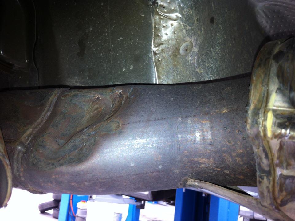

JETURBO ...JD TUNING ADELAIDE... Legacy Donating Member 23,708 Member For: 18y 4m 9d Gender: Male Location: Adelaide Posted 20/10/12 09:52 AM Posted 20/10/12 09:52 AM (edited) arhhhhhh pulled the old joint out , good workI went full twist and schnapp in the middlewere u at the strip ? Edited 20/10/12 09:52 AM by JETSNOT

AirStrike Legacy Donating Member 387 Member For: 17y 10m 18d Gender: Male Posted 21/10/12 04:41 AM Posted 21/10/12 04:41 AM Seems the ol' FG shaft isn't a fan of too much torque!
FPVFGS Member 359 Member For: 14y 5m 8d Gender: Male Location: Mornington Posted 21/10/12 10:14 AM Author Posted 21/10/12 10:14 AM lol I got more pics uploading for you know I had it on the hoist this morning ....gulp.... my bank balance is a bout to cop another hiding 2

FPVFGS Member 359 Member For: 14y 5m 8d Gender: Male Location: Mornington Posted 21/10/12 10:25 AM Author Posted 21/10/12 10:25 AM so these are the pics I took
RynoF6 Idiot Member Legacy Donating Member 446 Member For: 16y 8m 19d Gender: Male Location: Muswellbrook, NSW Posted 21/10/12 10:30 AM Posted 21/10/12 10:30 AM (edited) I twisted and smashed mine 5 weeks ago. Rang around to get prices on retubing and mal wood does an off the shelf item. Ended up going with Gibsons driveshafts in Newcastle.Stronger/thicker tubing, centre joint oversised to 35mm(from 30), 1350 uni joints. Slip join in second half and the rear cv has been swapped for a uni joint.Said it would take over 1000hp if needed. Less than half the mal wood price. Little over one G. Edited 21/10/12 10:36 AM by RynoF6 3
Bonjaz Legacy Donating Member 1,841 Member For: 17y 10m 2d Gender: Male Location: CQ Posted 21/10/12 10:46 AM Posted 21/10/12 10:46 AM did they balance it on the car ryno? or you took in your stuffed 1 and said I want a stronger straighter one of these please. I also called mal a while ago im pretty sure he said he needs your old shaft and he modifies it to handle the extra power but im not real sure what he modifies...
