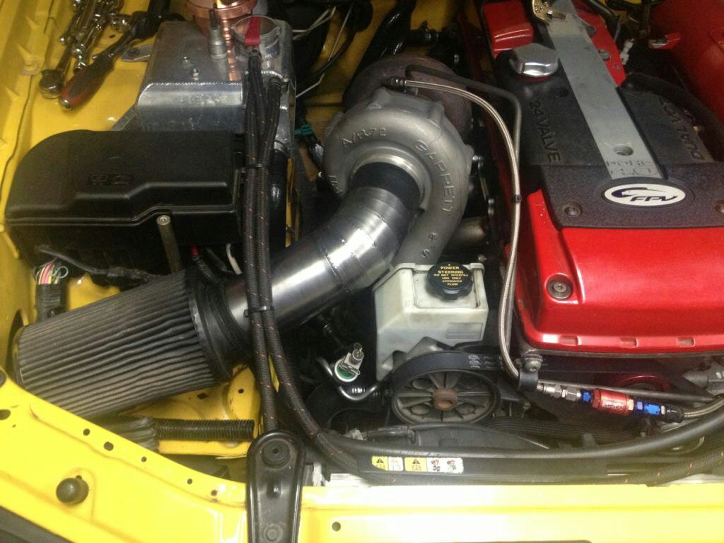

trentlikeshp Member 63 Member For: 13y 4m 27d Posted 07/02/15 08:38 PM Author Share Posted 07/02/15 08:38 PM bit of an update. manifold is all fabbed up, just have to pick it all apart and weld the pipes up.once the turbo is 100% home I'll start to knock up an exhaust.also fabbed up a neat lobster backed turbo side intake too. Link to comment https://www.fordxr6turbo.com/forum/topic/78672-330-rwkw-sleeper/page/11/#findComment-1528570 Share on other sites More sharing options...

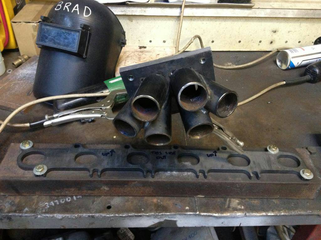

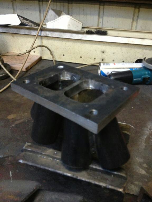

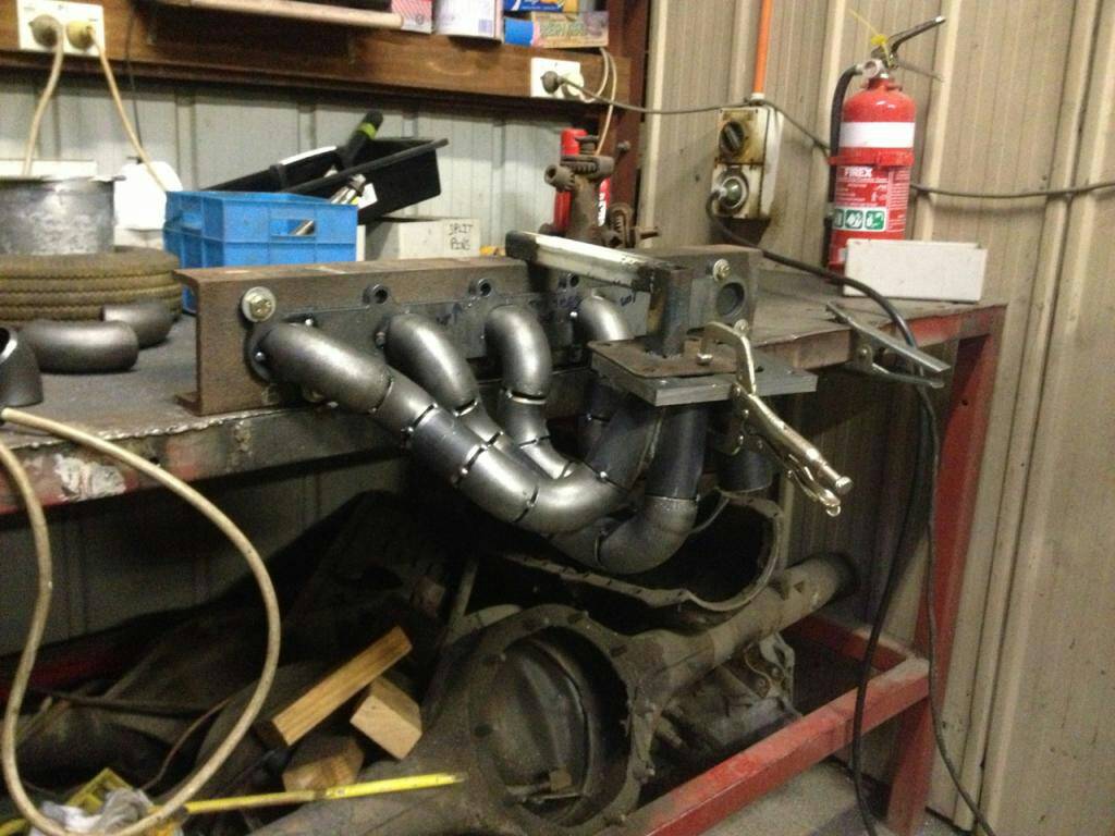

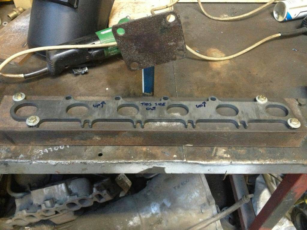

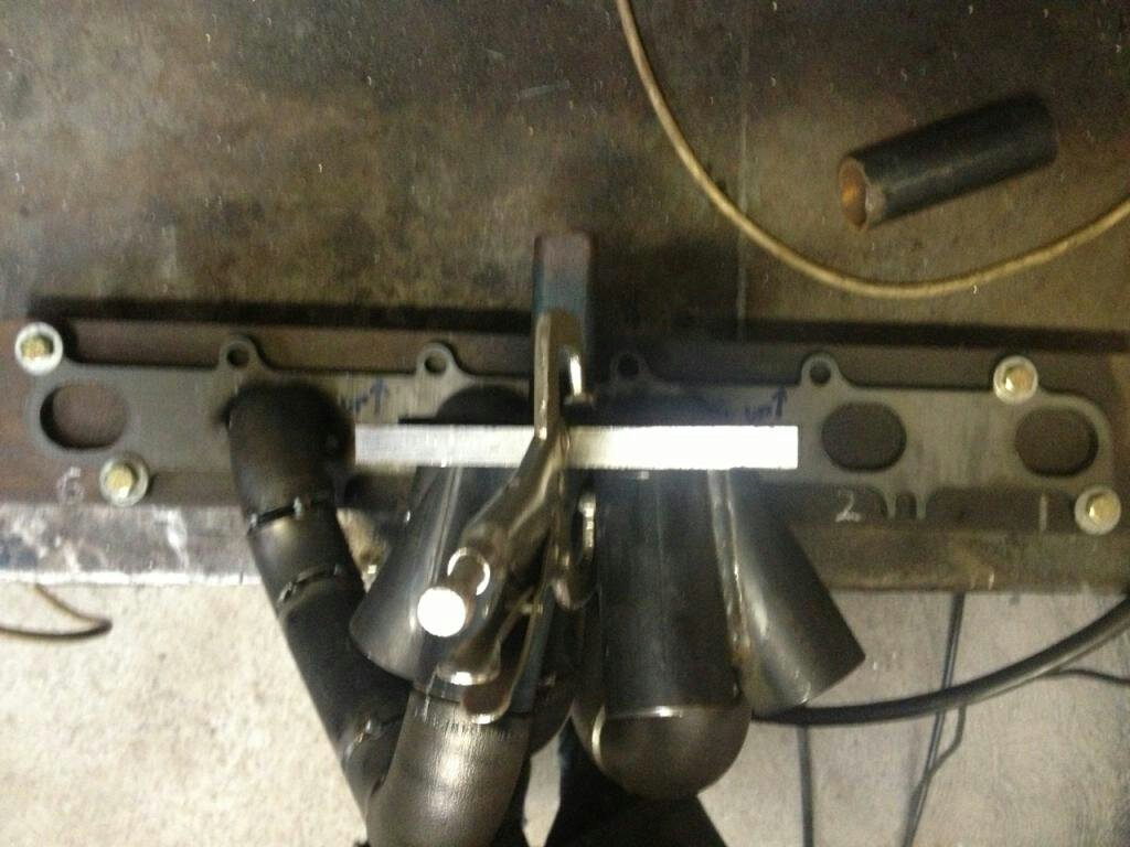

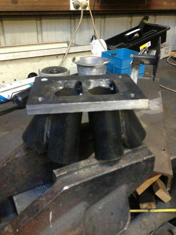

trentlikeshp Member 63 Member For: 13y 4m 27d Posted 07/02/15 11:54 PM Author Share Posted 07/02/15 11:54 PM cheers mate, really appreciate it I made the turbo flange and split pulse collector (no particular knowledge or 'proper' design with the collector, I was just winging it) splashed out and bought a laser cut header flange because I'm too lazy to make one. I made that jig for the flange placement off a 6boost manifold that I borrowed from a mate.however his manifold was for a gtx45 which puts the turbine all but right against the rocker cover which I didn't like.seeing the t51 is a lot smaller, I moved it toward the strut tower 20mm and forward 30mm (hence why the collector is clamped to the jig and not bolted)and then basically just played join the dots while trying to not screw my own ass by making it too hard to get a dump pipe out the back or getting the hot side onto the comp outlet.I lobster backed the intake with some 3.5" exhaust pipe that I had laying about which will be getting ceramic coated along with the manifold and maybe dump pipe depending how the cash flow is at the time. and that's about all for the moment Link to comment https://www.fordxr6turbo.com/forum/topic/78672-330-rwkw-sleeper/page/11/#findComment-1528590 Share on other sites More sharing options...

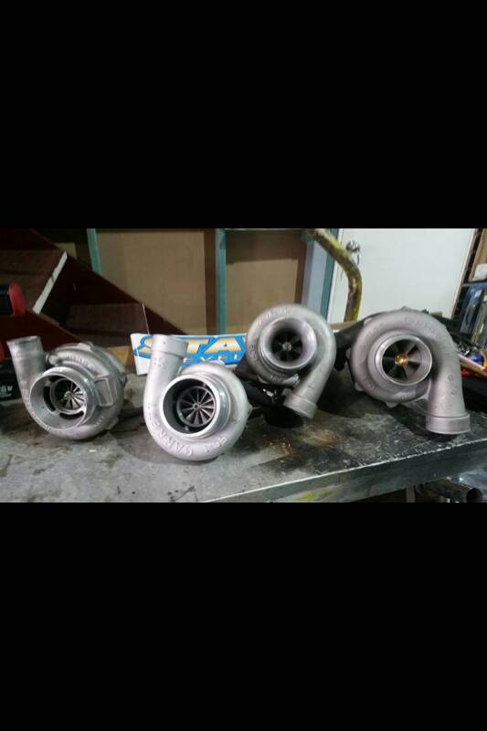

trentlikeshp Member 63 Member For: 13y 4m 27d Posted 07/02/15 11:55 PM Author Share Posted 07/02/15 11:55 PM oh and the photo of the turbos is just a comparison, not hard to figure out which is which lol Link to comment https://www.fordxr6turbo.com/forum/topic/78672-330-rwkw-sleeper/page/11/#findComment-1528591 Share on other sites More sharing options...
trentlikeshp Member 63 Member For: 13y 4m 27d Posted 13/02/15 05:52 AM Author Share Posted 13/02/15 05:52 AM got all the pipes welded yesterday, gotta piece it back together and weld to the header flange and collector pipes and pray they haven't distorted too much (fingers crossed) then mill the flange surfaces nice and flat if need be and take to work on Monday and have it blasted ready for coating.then all down hill from there making an exhaust Link to comment https://www.fordxr6turbo.com/forum/topic/78672-330-rwkw-sleeper/page/11/#findComment-1529911 Share on other sites More sharing options...
