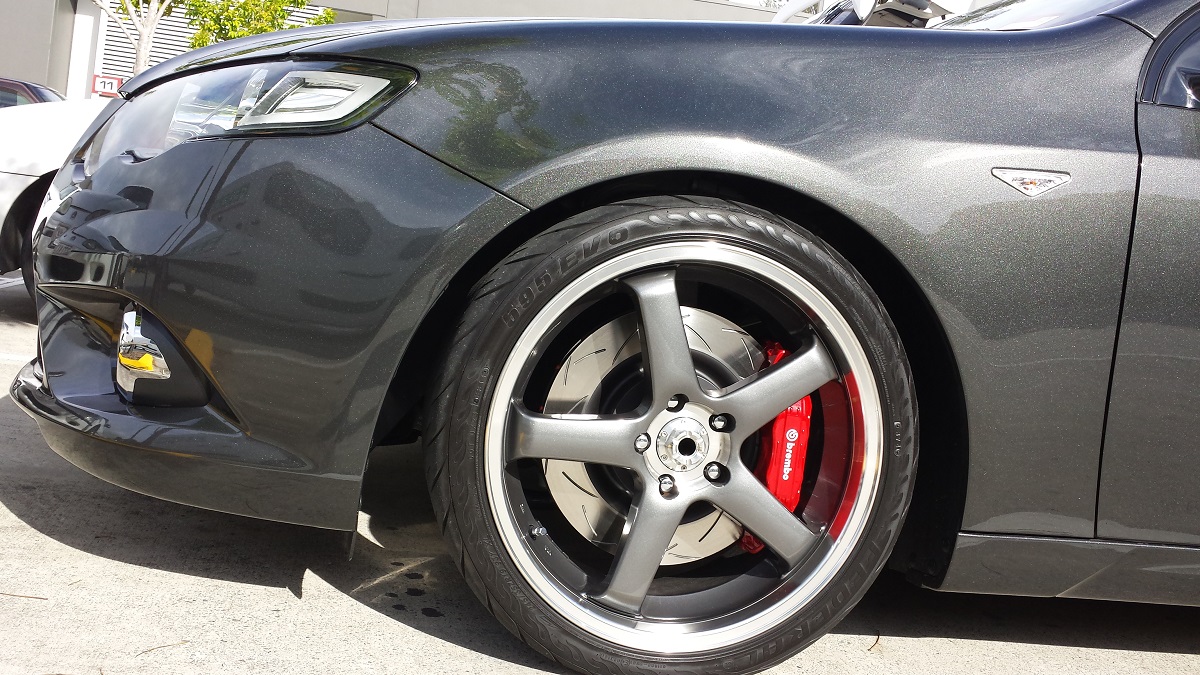

Bomber Carnage on the Garage Floor Legacy Donating Member 3,994 Member For: 16y 4m 11d Gender: Male Location: Gold Coast Posted 09/01/14 09:01 AM Author Posted 09/01/14 09:01 AM 5
XtRmn8 570Nm @1800rpm Legacy Donating Member 2,441 Member For: 23y Gender: Male Location: Perth, WA Posted 09/01/14 09:49 AM Posted 09/01/14 09:49 AM Nice one Do you have rubber grommets for the handbrake adjustment in you rear disks?I can't find any 10mm grommets to suit the 328mm DBA disks and the OEM ones are too big.
Bomber Carnage on the Garage Floor Legacy Donating Member 3,994 Member For: 16y 4m 11d Gender: Male Location: Gold Coast Posted 09/01/14 11:15 AM Author Posted 09/01/14 11:15 AM Don't know about the grommets mate sorry. Was professionally installed by better brakes on the gold coast. Noticed the handbrake has been adjusted however. I'll ask for you.Feeling better as they bed in. Was green on green. With some heat into them I think they'll be excellent.I weighed all components to compare. Interestingly, the 4 piston brembos were only 700g heaver in total. Both loaded with pads - including brake lines. However, the rears were 3.5kg in total. The 355mm fronts were a shade under 2kg each heaver than the 322mm RDA rotors I had on. All in all, she's porked up 11.9kg. I was hoping it would be no more than 10kg but no biggie. If you went with DBA 5000's with alloy hats you'd trim off approximately 700g per rotor. At $400 extra a pair though - hard to justify.Very happy to get this finally done. Just need moar powar now to make up for the weight increase 1
XtRmn8 570Nm @1800rpm Legacy Donating Member 2,441 Member For: 23y Gender: Male Location: Perth, WA Posted 09/01/14 12:27 PM Posted 09/01/14 12:27 PM Thanks for that. Smallest grommet for sell is 14mm. I should probably just call DBA re the grommets. What pads are you running mate? I've only done about 150km since fitting mine so they are not bedded in yet but feel heaps better with moderate brake pressure.
Bomber Carnage on the Garage Floor Legacy Donating Member 3,994 Member For: 16y 4m 11d Gender: Male Location: Gold Coast Posted 09/01/14 10:34 PM Author Posted 09/01/14 10:34 PM (edited) Mathew from Race Brakes Sydney supplied 'Bremtec' ceramic technology thingies to try. The have soft backs etc so will be quiet and low dust he reckons. Wasn't too concerned about bite because the upgrade with much greater contact area and a vented rotor is where the gains will come for my application. If tracking the car you'd go more aggressive. Fronts pads are Brembo. Edited 09/01/14 10:36 PM by Bomber
