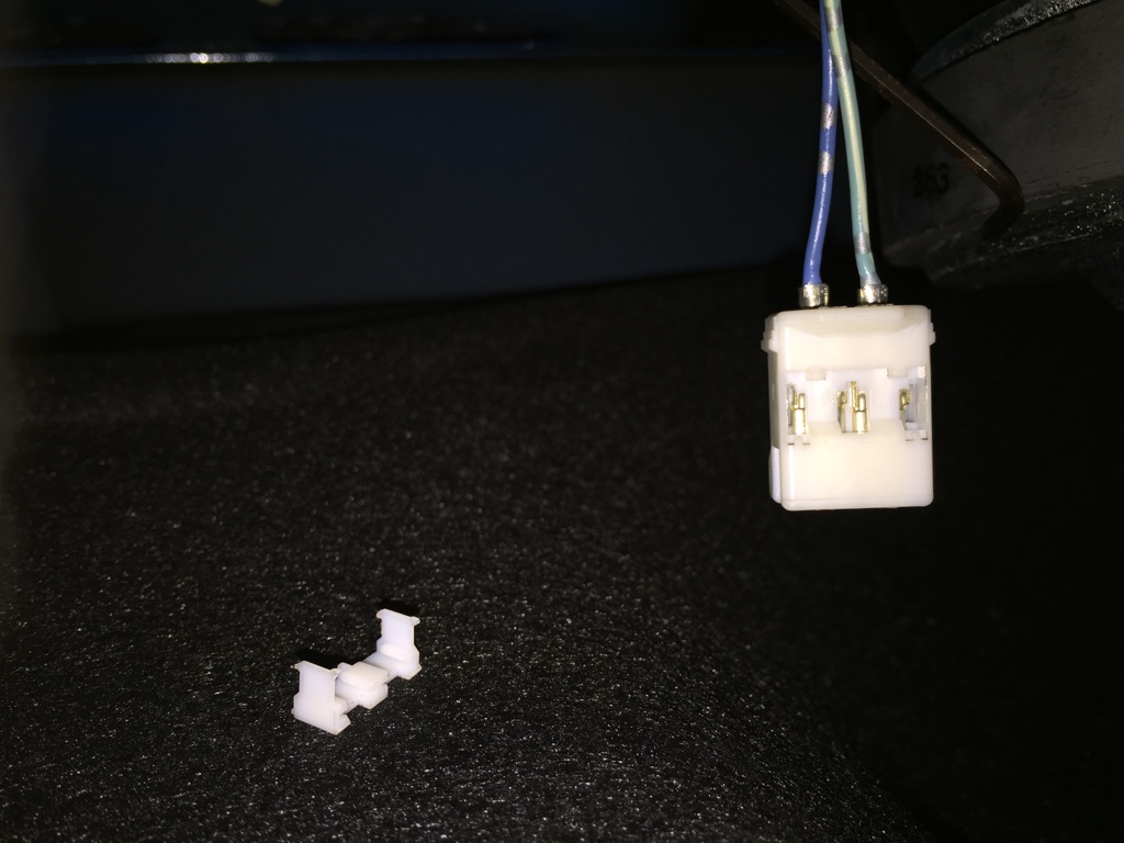

.Stripes. All stock bar the k&n panel filter Silver Donating Members 8,061 Member For: 13y 1m 21d Gender: Male Location: Perth Posted 14/10/14 12:56 AM Share Posted 14/10/14 12:56 AM Screwdriver? That's what my sparky mate did...looked easy enough... 1 Link to comment https://www.fordxr6turbo.com/forum/topic/74886-fg-sub-fix/page/21/#findComment-1506080 Share on other sites More sharing options...
Lennox Member 2,586 Member For: 12y 2m 8d Gender: Male Location: Perth Posted 14/10/14 01:17 AM Share Posted 14/10/14 01:17 AM Yeh usually some metal barbs you have to poke down flat before you can pull the cable back out. 1 Link to comment https://www.fordxr6turbo.com/forum/topic/74886-fg-sub-fix/page/21/#findComment-1506083 Share on other sites More sharing options...
Rydeit Member 327 Member For: 12y 9m 24d Gender: Male Location: Adelaide S.A Posted 14/10/14 04:22 AM Share Posted 14/10/14 04:22 AM Ended up going past the local car audio store. Got them to just crimp and swap the wires over. Wow what a difference haha. Whoever says it makes no difference must be deaf. MUCH more crisp bass. Almost sounds like an aftermarket sub now. Doof doof for dayssss Link to comment https://www.fordxr6turbo.com/forum/topic/74886-fg-sub-fix/page/21/#findComment-1506116 Share on other sites More sharing options...

norrs Donating Members 448 Member For: 17y 9m 12d Gender: Male Location: Darwin Posted 12/11/14 12:23 PM Share Posted 12/11/14 12:23 PM Well on my fg 2010 f6 I pulled the plugs from the clip. You got to pull this bit out firstThen I could swap it back and forth within seconds to test it. Made no difference either way :( Link to comment https://www.fordxr6turbo.com/forum/topic/74886-fg-sub-fix/page/21/#findComment-1511910 Share on other sites More sharing options...

YEH RIGHT Member 53 Member For: 10y 7m 13d Posted 13/11/14 02:57 AM Share Posted 13/11/14 02:57 AM so which way "should" they be and which way did they leave factory, the pic is abit unclear.. should the light blue wire be towards the front of the car or to the rear?? Link to comment https://www.fordxr6turbo.com/forum/topic/74886-fg-sub-fix/page/21/#findComment-1511982 Share on other sites More sharing options...
norrs Donating Members 448 Member For: 17y 9m 12d Gender: Male Location: Darwin Posted 13/11/14 05:41 AM Share Posted 13/11/14 05:41 AM Green was near boot and blue was to front. 1 Link to comment https://www.fordxr6turbo.com/forum/topic/74886-fg-sub-fix/page/21/#findComment-1512000 Share on other sites More sharing options...
YEH RIGHT Member 53 Member For: 10y 7m 13d Posted 13/11/14 06:35 AM Share Posted 13/11/14 06:35 AM Sorted.. ended up trying both ways, swapped around it made it alot better, crisp I guess you'd say Link to comment https://www.fordxr6turbo.com/forum/topic/74886-fg-sub-fix/page/21/#findComment-1512017 Share on other sites More sharing options...
