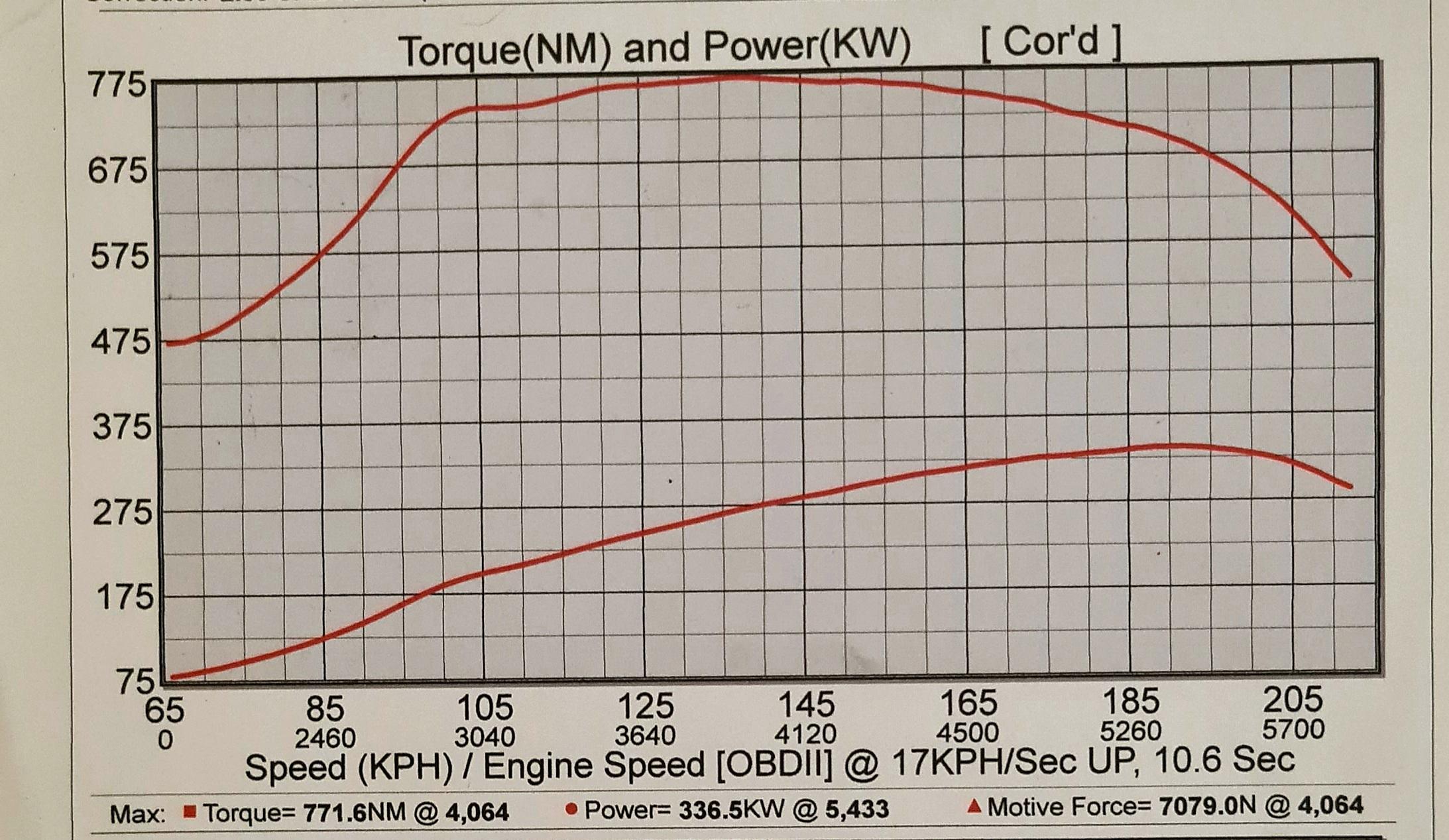

  9. 336rkw 🤟 at 11psi. Used weird products to get there, not the standard route 😎🤟 Venom Dump and High Flow Cat Turbosmart Dual Port BOV Process West CAI Bosch 1000cc Injectors Intune Motorsport Intercooler Piping Intune Motorsport Turbo Muffler Delete Intune Motorsport Braided Turbo Oil Line Kit Autotecnica Intercooler SCT4 Tuner Mamba GTX3584R Dual Ceramic Turbo Mamba 12Psi actuator Non Performance Upgrades; Nolathane rear centre and side bushes. Nolathane front swaybar bushes Gas shocks Drilled and Slotted front rotors Stainless Turbo/Exhaust Gaskets OBD2 LCD gauge cluster Absolutely love my unassuming looking comfortable side stepper 😁💪😎 To be installed; M86 TruTrac Crow or Atomic Valve Springs Upgraded Fuel pump Battery Relocation Kit Turbosmart 14psi Actuator Retune. May need bigger intercooler May need cat back
