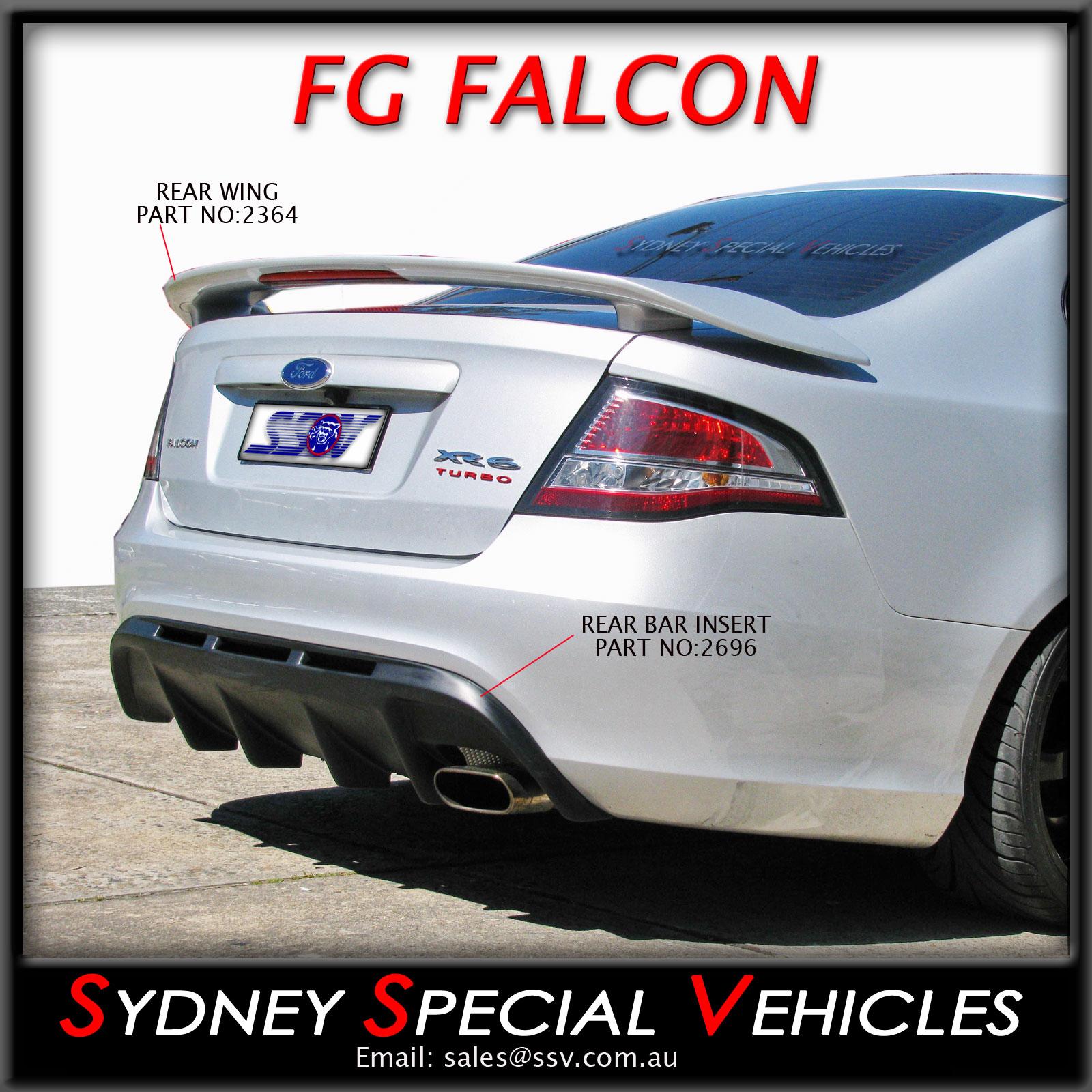

Snowbear77 Member 102 Member For: 4y 10m 17d Gender: Male Location: Perth Posted 01/01/21 06:24 PM Share Posted 01/01/21 06:24 PM Hey all, I'm definatley a fan of F6 rear bumper, but have been told the diffuser is not interchangeable, like on the standard FG rear bumper. I dont have direct access to an F6 rear bumper, and have no idea how the diffuser is attached......... Has anybody ever merged the rear bumper ( F6 +, ( with the single exhaust diffuser picture attached with success)? Link to comment https://www.fordxr6turbo.com/forum/topic/96102-replacing-the-diffuser-on-the-f6/ Share on other sites More sharing options...
JETURBO ...JD TUNING ADELAIDE... Gold Donating Members 23,708 Member For: 17y 1m 8d Gender: Male Location: Adelaide Posted 02/01/21 04:38 AM Share Posted 02/01/21 04:38 AM Don’t do it, Fit the full F6 rear bumper as they look nice on XR’s but do not attempt the diffuser. I’ve got numerous customers with them and they just don’t fit right not matter what you try and do as they’re designed to be “Glued” on with Sikaflex Link to comment https://www.fordxr6turbo.com/forum/topic/96102-replacing-the-diffuser-on-the-f6/#findComment-1701785 Share on other sites More sharing options...
Snowbear77 Member 102 Member For: 4y 10m 17d Gender: Male Location: Perth Posted 03/01/21 12:39 AM Author Share Posted 03/01/21 12:39 AM I purchased mine from MR bodykit ( SYDNEY ), and comes with mounting screws.............( though, The first one I received was buckled very badly, and have since had a replacement sent in it's place ), though I wont get around to doing anything with it till early February, when I'm having the rear bumper painted. Link to comment https://www.fordxr6turbo.com/forum/topic/96102-replacing-the-diffuser-on-the-f6/#findComment-1701798 Share on other sites More sharing options...
espoig Donating Members 249 Member For: 10y 10m 4d Gender: Male Location: Mundaring Posted 03/01/21 11:26 AM Share Posted 03/01/21 11:26 AM Its all one piece, you'll need too cut it out, I'd definitely take it to a competent body shop, I used my mate locally who got it fitted in my xr bumper real good Link to comment https://www.fordxr6turbo.com/forum/topic/96102-replacing-the-diffuser-on-the-f6/#findComment-1701808 Share on other sites More sharing options...
