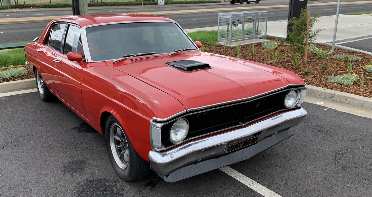

7-DBE620-A-DB43-40-E9-9-FCE-ADAFE209-A6-hey people
I inherited this from my father...I’m not a v8 guy I’m a Rotary freak but have a fg xr6t with 420hp @ wheels which I’ve come to enjoy as my family car ...so I’m going to Tuff Mount a Barra in to my Fairmont but I will keep the C4 gearbox an I’m going to keep the motor scoop which I’ll fit somehow to the Barra ....Now the Fg is 400kgs heavier than the Xy, so I see an easy 11sec car in the end maybe even 10sec is on the cards...
I’ll keep you all updated as I progress this build..

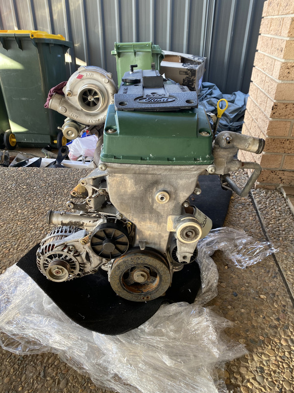

Progress ;
78118-F90-A78-A-4-B57-960-B-E5028-B0-B8-
I have the 2006 bf motor...Now to start stripping the crap of it...
Now look at it....
FC739-B4-F-E979-4-F61-B400-9655353839-BA
I have a torque power bell housing to pick up tomorrow for the C4 ....I have a FG turbo an Exhaust manifold plus I have an FG fuel rail with 1000cc kpm injectors ...I’m waiting to fit the motor in the engine bay to see my options for intake manifold...Happy days...
