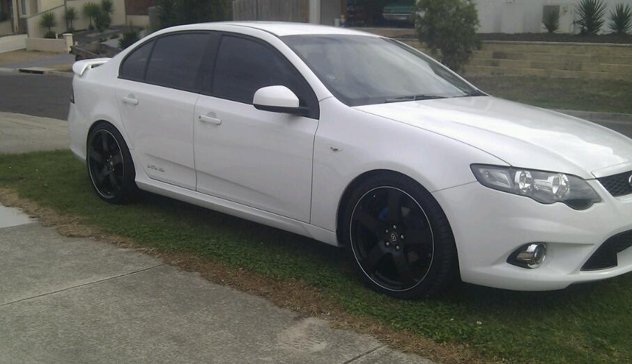

karps Member 14 Member For: 14y 9m 11d Posted 30/09/11 03:54 AM Share Posted 30/09/11 03:54 AM Hey guys,This is my xr with 20x8.5 and 20x10 (275s) at the rear.I've got it lowered on SSL's, I did have issues with scrubbing at 1st, then we shaved 3.5mm off the offset, which solved the scrubbing. Not sure what the offset is exactly, but I went for a few drives with a full car and have no issues with scrubbing. Not to mention, there was a noticeable difference in the handing. Link to comment https://www.fordxr6turbo.com/forum/topic/92946-fg-offsets-and-tyre-questions/page/11/#findComment-1145131 Share on other sites More sharing options...
