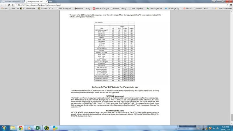

HI PSI Member 1,589 Member For: 19y 4d Gender: Male Location: Central Queensland Posted 18/04/15 11:46 AM Author Share Posted 18/04/15 11:46 AM I just reading some stuff on the the Kenne Bell - Boost-A-Pump. See Kenne Bell Fuel & HP Estimator for HP and injector size. *The Kenne Bell BOOST-A-PUMP® works with all the above listed OEM pumps and wiring. No expensive billet hats, re-wiring or plumbing is necessary. Pumps shown with N/Aare “Not Applicable.”WARNING (Amperage) The Walbro and Aeromotive pumps used in either single or dual applications obviously produce more flow than stock pumps - BUT AMPERAGE IS MUCH HIGHER. Example: Up to 73% 14.2-17.2 vs 9.9 amps (Walbro Gss340). Therefore, the stock wiring system is incapable of handling the increased loads and must be upgraded or replaced. This higher amperage also negates using the BOOST-A-PUMP™ and it’s 17.5-20V advantage. The BOOST-A-PUMP™ is not designed to operate these high amp pumps. Check out the flow numbers and cost of the 2 approaches. See Kenne Bell “Fuel & Horsepower Estimator” to determine HP.I guess that the Kenne bell is now out of the picture..... Link to comment https://www.fordxr6turbo.com/forum/topic/90383-fuel-pump-voltage-boostercontroller/page/3/#findComment-1540405 Share on other sites More sharing options...
