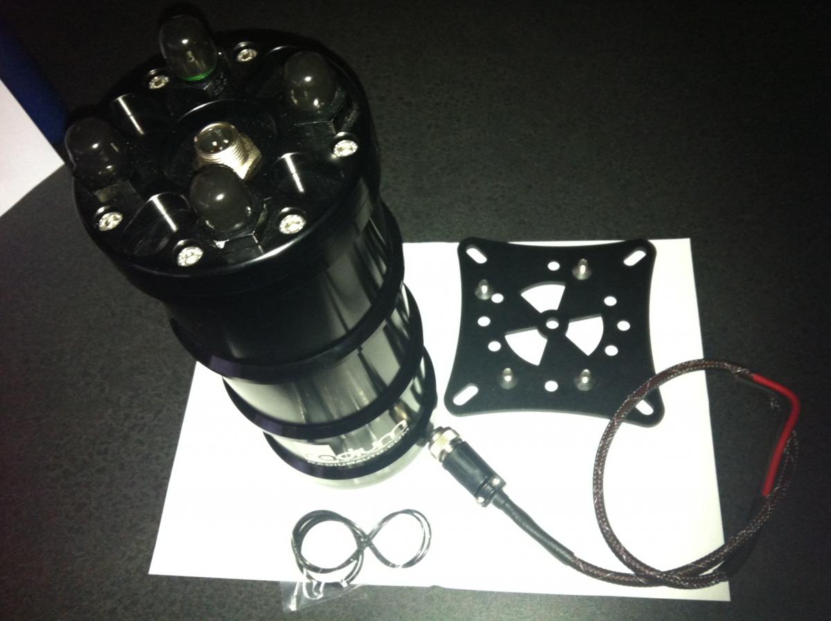

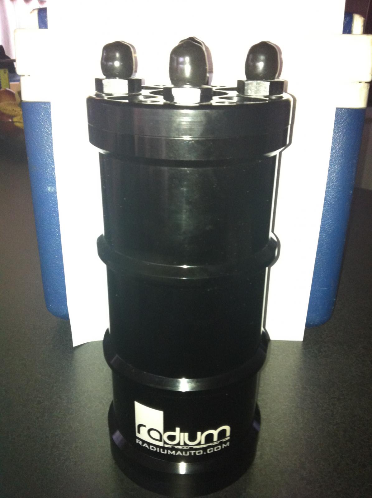

OK,
so attached pics show my new surge tank. It houses a Walbro 400 like I mentioned above, -6an fittings and holds around 1.5L from what I can find on the web page.
Pretty neat bit of gear I think.
Reasonably priced too and will fit on the rail in my FG like the other units on the market.
green fitting is pump out.

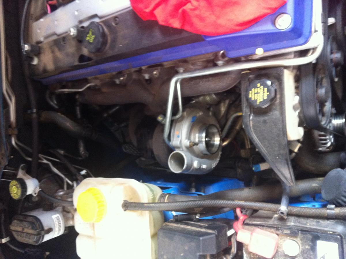

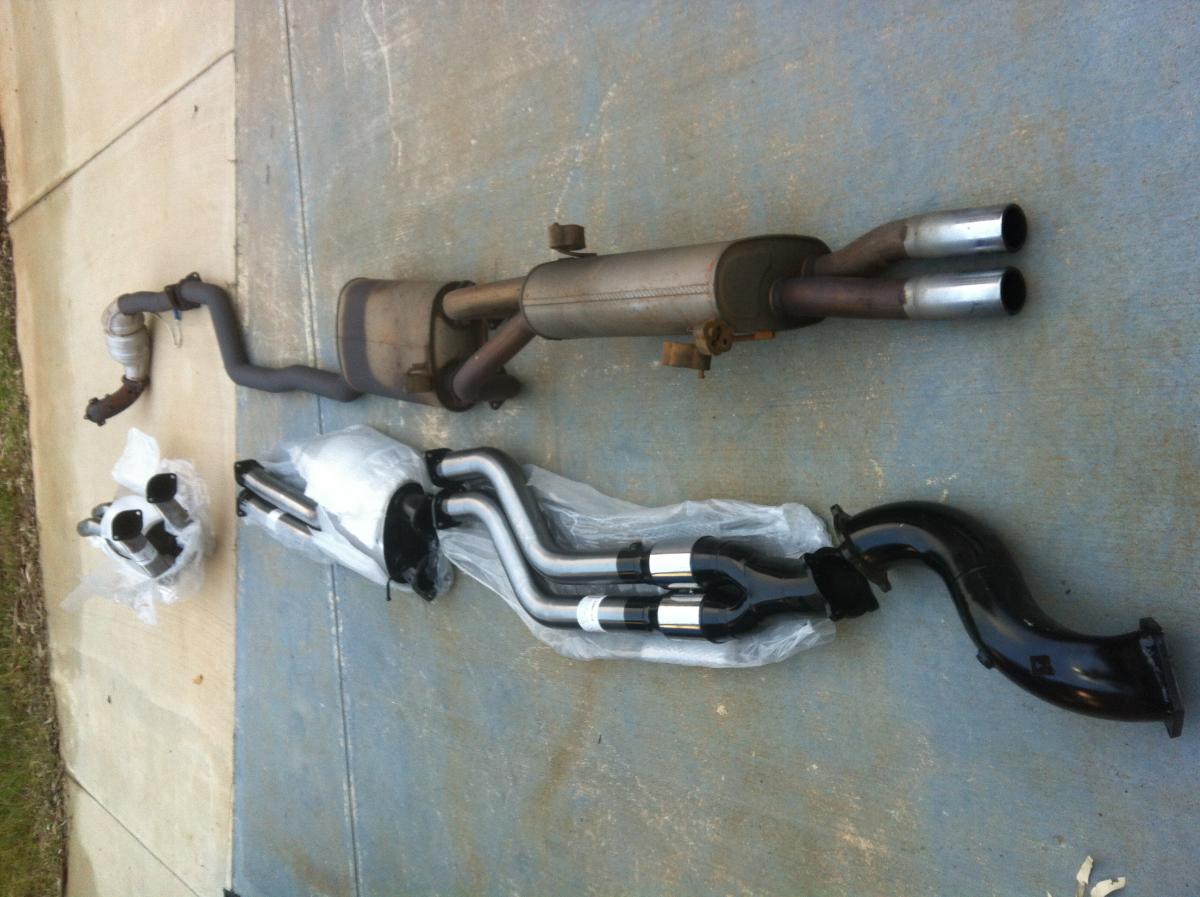

with the assistance of a fellow forum member and his awesome workshop works have started...
The turbo is out (pics soon)
injectors are in, new exhaust is in place, plugs are gapped, thermostat has been fitted <--- the housing had some low spots on it in the casting so it was draw filed back flush on both sides for better contact.
the exhaust bolts weren't too bad to get off, I was expecting much worse, although at 34000km, maybe its not long enough to weld them in place. the new exhaust is a thing of beauty... all shiny and big, went in with out a hitch which I was most impressed about
some pics of the previous days efforts.
New intake bend too... a touch bigger than the stock item.

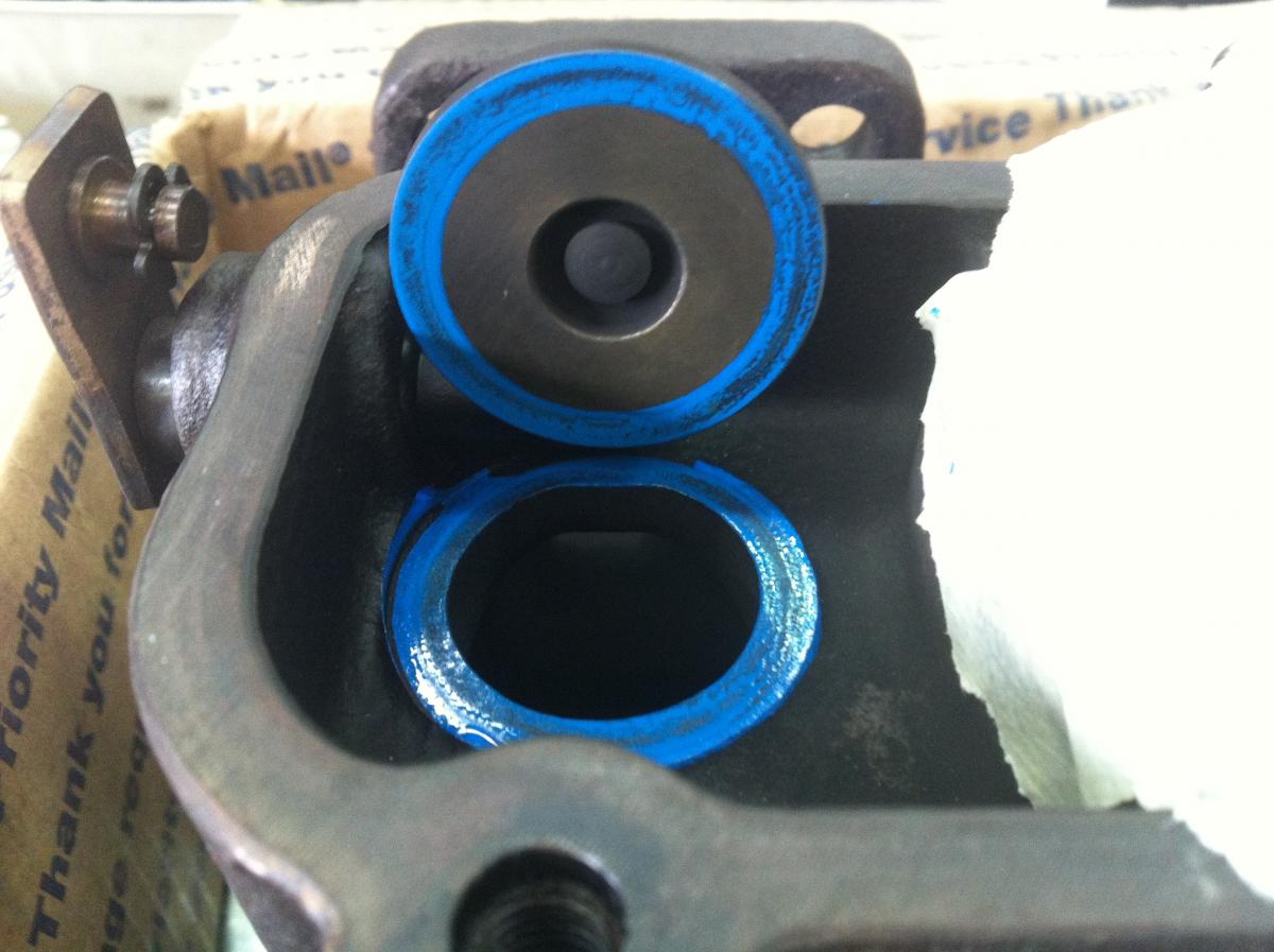

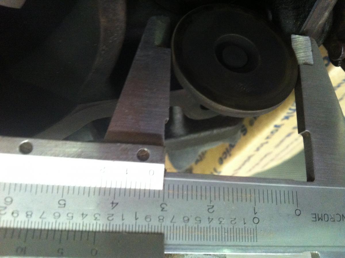

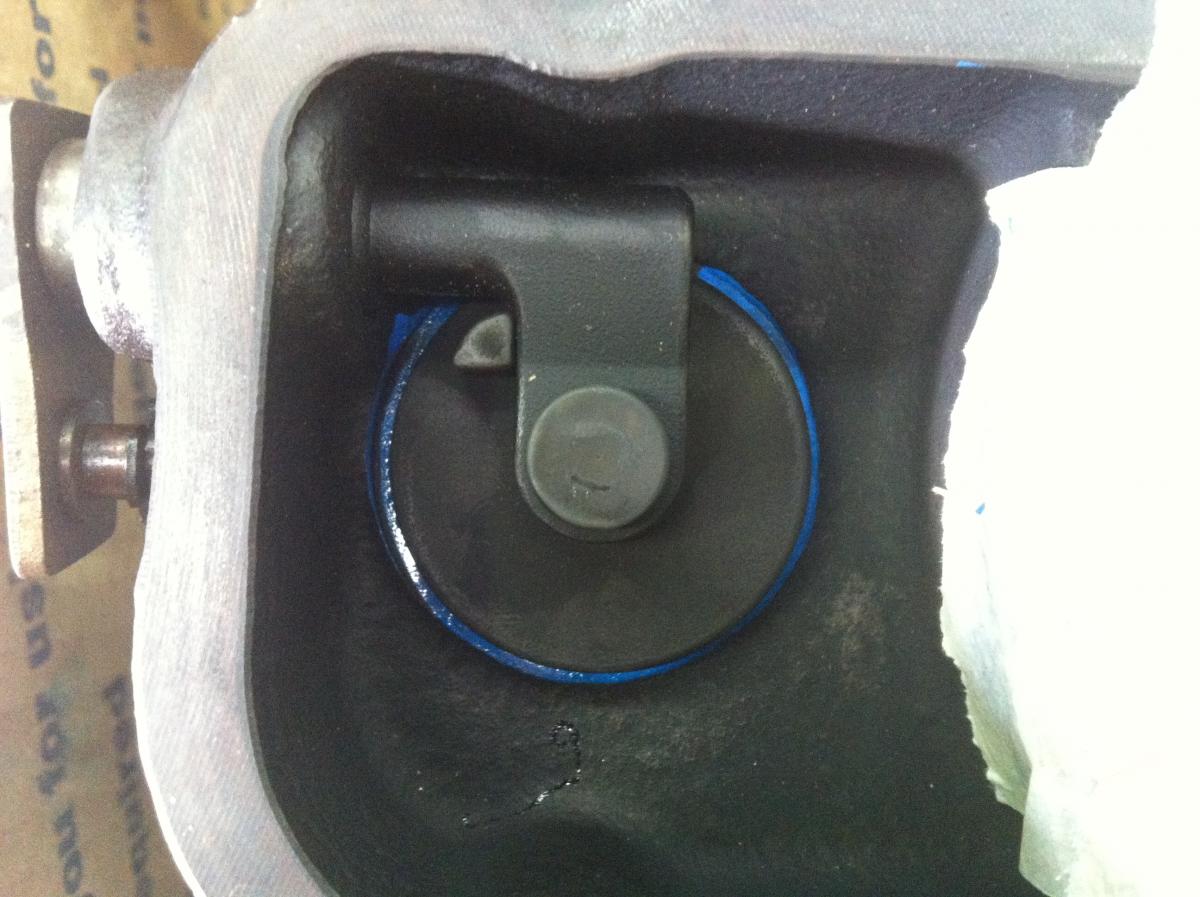

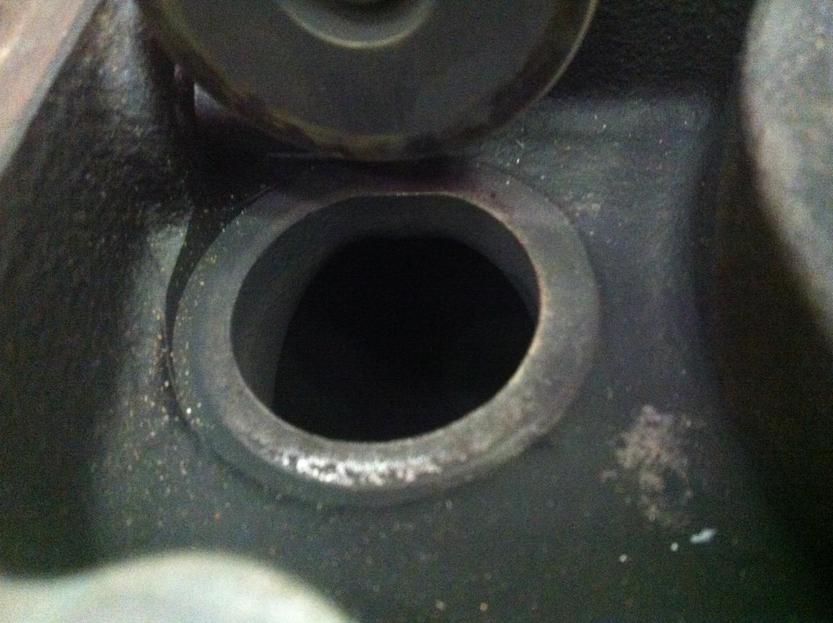

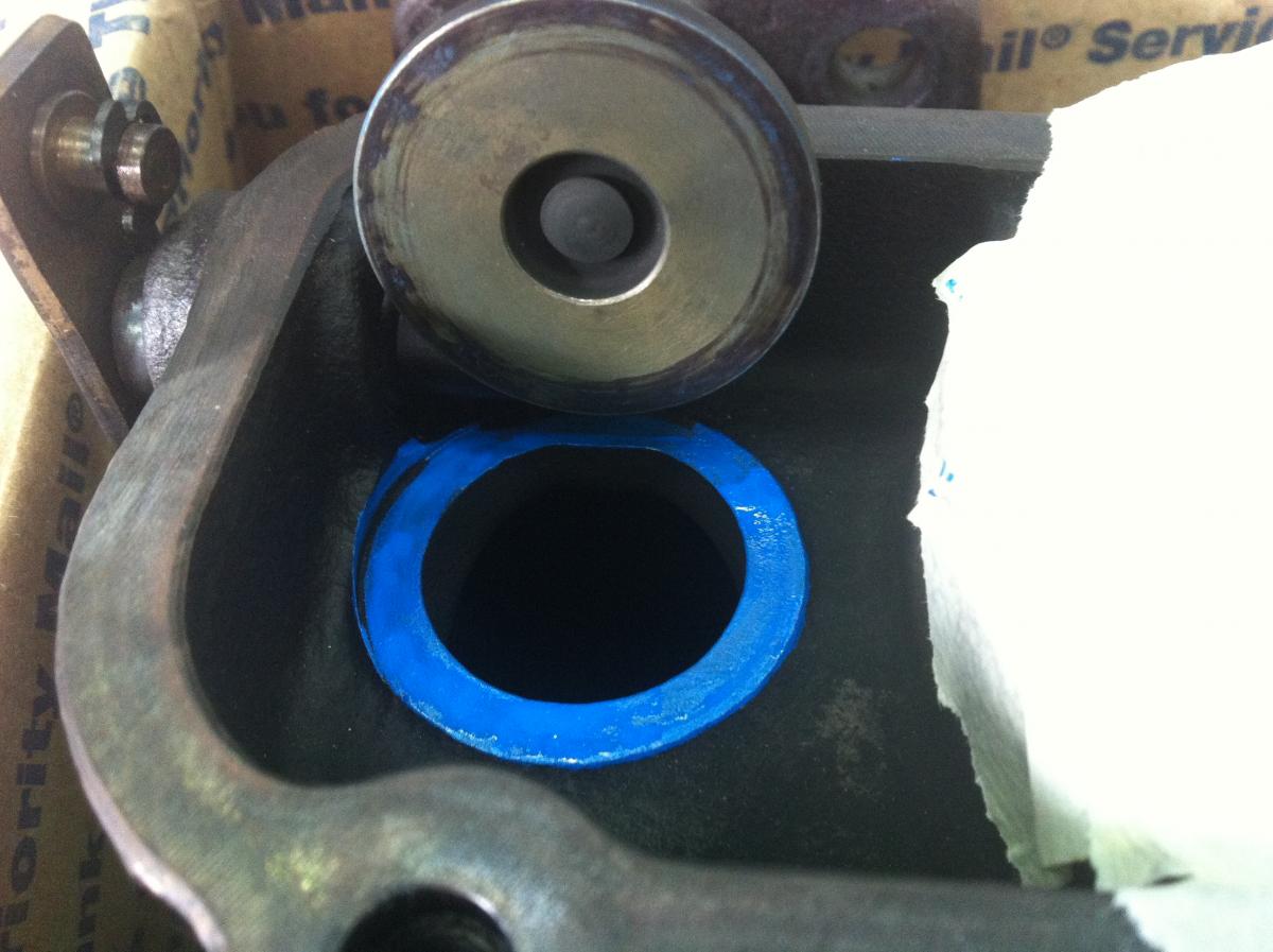

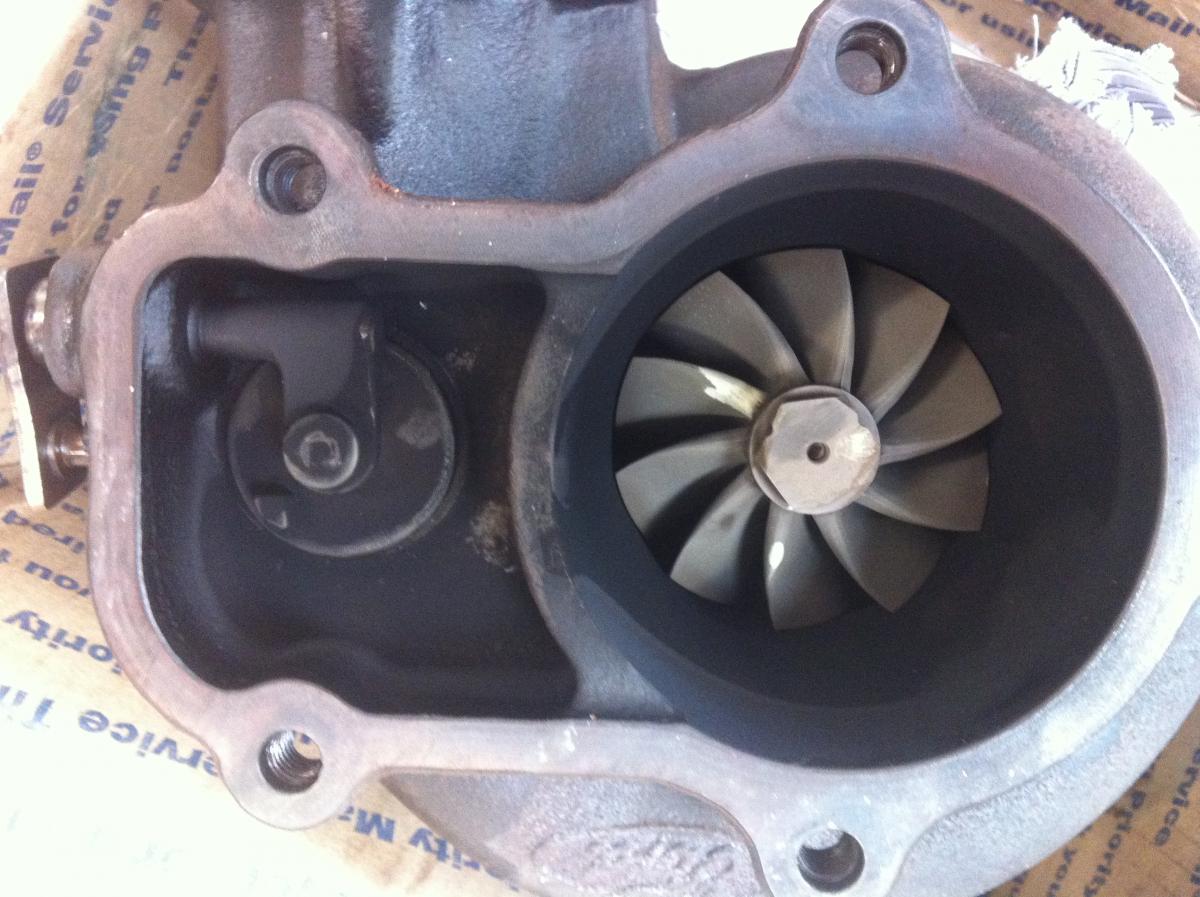

OK, some pics of the turbo before the work..
button is 33mm in dia... this will change to 38mm
button seat area is 3mm wide... this will become 1mm
bore dia is 27mm (not incl the top flat portion) this will become 36mm
blue paint just to highlight areas before work.
The internal shot just there to show factory casting flow path.
cheers
