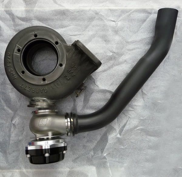

Henz Tampon inserted, Auto Acquired, next purchase a new handbag Legacy Donating Member 9,946 Member For: 18y 6m 2d Gender: Male Location: Vic Posted 05/05/11 05:20 AM Posted 05/05/11 05:20 AM Lol at that setup, hope the first copper that pulls you over is a nice one!!If you do this, keep it out of sight! ETMs kit puts it under the heat shield.
Marsh Member 9 Member For: 16y 3m 14d Posted 06/05/11 06:26 AM Author Posted 06/05/11 06:26 AM (edited) This setup uses a custom manifold. Location of wastegate would make for easy wastegate adjustments/spring changes though.Keep the photos coming I need ideas Henz... Is there something ilegal about an external wastegate? (im serious I dont know) Edited 06/05/11 06:28 AM by Marsh
Stazza_Brendan Legacy Donating Member 686 Member For: 16y 11m 11d Gender: Male Location: Mackay QLD Posted 07/05/11 08:03 AM Posted 07/05/11 08:03 AM Dont know why external gates would be illegal. A small number of cars have factory external gates.
Henz Tampon inserted, Auto Acquired, next purchase a new handbag Legacy Donating Member 9,946 Member For: 18y 6m 2d Gender: Male Location: Vic Posted 07/05/11 10:50 PM Posted 07/05/11 10:50 PM From a coppers point of view, seeing an external gate sitting in the engine bay is a huge giveaway to big mods. Any HP will know 90% of external gates are coupled with a screamer. That turbo posted has an aftermarket manifold, they should have just put it onthere out of sight!
XF Falcon <put funny sh*t here> Member 3,365 Member For: 19y 10m 13d Gender: Male Location: Perth, NOR Posted 09/05/11 04:02 PM Posted 09/05/11 04:02 PM (edited) External wastegates are legal so long as they go back into the exhaust and not a screamer type setup.my ETM kit has the wastegate off the rear housing, and it works well, plus its tucked away out of sight too so you can't see it. Its better than the 90 degree angle shown in the first pic.Here is mine prior to fitting. Edited 09/05/11 04:04 PM by XF Falcon
Marsh Member 9 Member For: 16y 3m 14d Posted 10/05/11 12:36 PM Author Posted 10/05/11 12:36 PM Xf Falcon thanks for sharing do you have any more pics.? Looking for a shot down the turbine inlet?Also what size waste gate is that?Tochi, Twin scroll one would be ideal to see looking down the exhaust inlet did you get this sort of pic of yours?(nice Capri BTW) I was going to ask in your build thread but didn't want tO disturb
