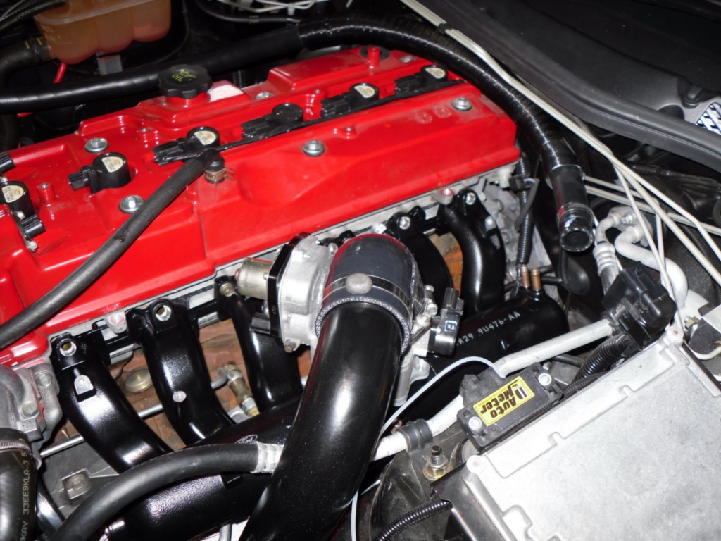

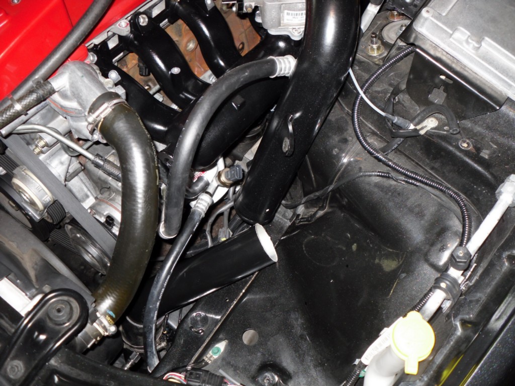

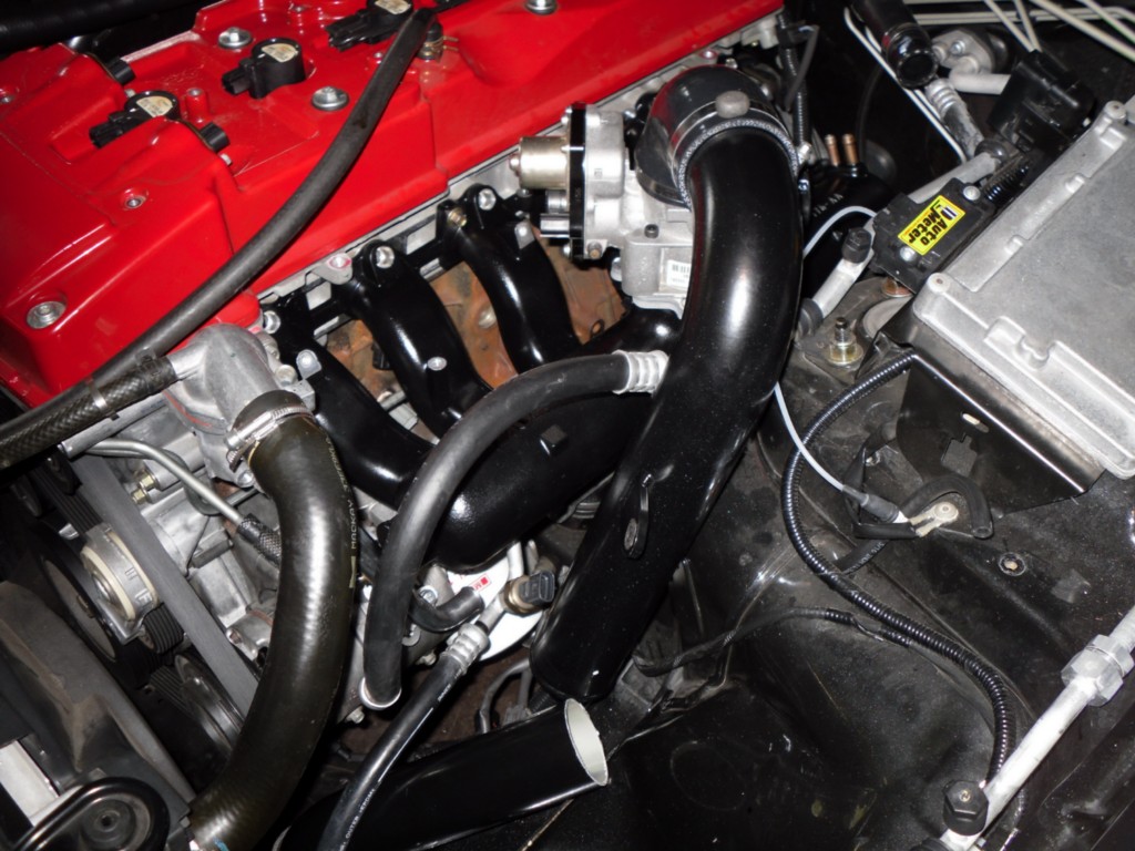

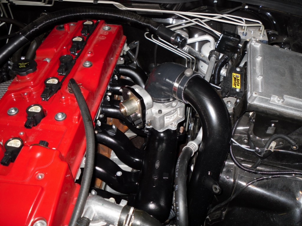

Guest EGOXRT Guests Posted 16/01/10 06:05 AM Posted 16/01/10 06:05 AM (edited) Ok, just a small update. Started on the conversion yesterday, what a Pita of a job to get that carp off..For those thinking of doing this be warned it is not for the faint hearted. The first problem you will encounter is the water pipe from the thermostat housing that goes around the back of the motor, it fouls the FG manifold and needs to be modified.I cut mine, and swung it around to clear the manifold, and will join it using rubber hose. The FG pipe is totally different and will also need to be modded so,I thinkit it easier to just cut the existing one up. You will need to bead the pipe ends and re plate it!.The next is clearance between the TB bend and bonnet, I made the bend as tight as possible and managed 15mm, not much but hey, it doesn't foul. This is because the BA TB is much higher than the FG one plus, the adaptor I made up adds 10mm to the height. Then there is the joys of getting the piping right. I ammaking temporary piping with the PW stage 2 ones that I had fitted, then off to a fabricator... Also, the dip stick bracket needs to be cut off, and relocated lower down, no big problem there though..Overall if you are not REALLY handy with tools I would not attempt this, I am so, it is a viable option for me. A couple of pics for those interested.. Edited 16/01/10 06:06 AM by EGOXRT
PHANTMXR6 It's not a MKI! Member 1,742 Member For: 18y 3m 14d Gender: Male Location: Earth Posted 16/01/10 06:45 AM Posted 16/01/10 06:45 AM Any reason you've mounted the throttle body at a 45 degree angle instead of straight on the manifold?

Dyno Junkie Member 254 Member For: 19y 6m 16d Gender: Male Location: Ascot, Western Australia Posted 16/01/10 09:22 AM Posted 16/01/10 09:22 AM Any reason you've mounted the throttle body at a 45 degree angle instead of straight on the manifold?I agree, it must cause some flow issues at certain revs/boost.Also would have gained more room under bonnet using a right angle adaptor between the manifold and thottle body, this would have had the throttle body sitting horizontal instead of vertical and as a side benifit increased the overal plenum volume .
Guest EGOXRT Guests Posted 16/01/10 12:39 PM Posted 16/01/10 12:39 PM It had to be mounted at that angle in order to be able to adapt to the manifold. The bolt spacings will not allow it to adapt any other wayunless, you fasten the adapter from below, pita!!You will suffer about the same ill effects from mounting it this way as the FG does, none.You could mount it in a similar fashion to the PW throttle body relocation, but why move the butterfly further away from the manifold entry, that makes no sense at all. Who says there is a need to increase the volume of this manifold any more tan what is at hand, bigger isn'talways better.
