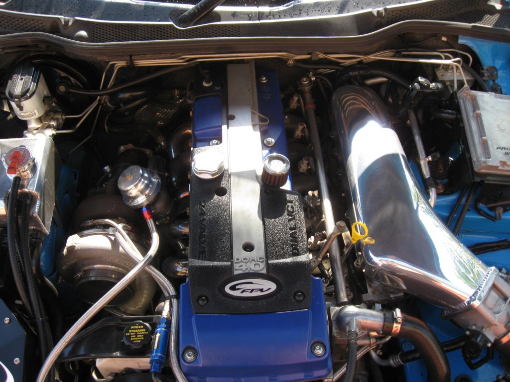

typhoon_freak Cryptic Clothing Company Donating Members 4,556 Member For: 17y 8d Gender: Male Location: Brisvages, Capalaba Posted 07/10/09 05:41 AM Author Share Posted 07/10/09 05:41 AM heres a few pics I was able to take while I had a some spare time. Link to comment https://www.fordxr6turbo.com/forum/topic/59685-my-build-to-500/page/4/#findComment-940761 Share on other sites More sharing options...

rhys86 Donating Members 443 Member For: 18y 6m 18d Gender: Male Location: Wollongong Posted 07/10/09 08:17 AM Share Posted 07/10/09 08:17 AM What turbo manifold is that?? Link to comment https://www.fordxr6turbo.com/forum/topic/59685-my-build-to-500/page/4/#findComment-940825 Share on other sites More sharing options...
dalts Member 755 Member For: 19y 1m 22d Gender: Male Location: brisbane Posted 07/10/09 09:39 AM Share Posted 07/10/09 09:39 AM that's the capa/gcg manifoldcheers lee Link to comment https://www.fordxr6turbo.com/forum/topic/59685-my-build-to-500/page/4/#findComment-940876 Share on other sites More sharing options...
