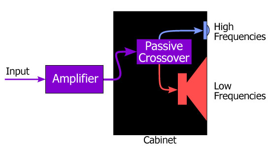

So how does the sound get to each driver…
Brings in the next part of the system –
Crossover-
* Whats a crossover?
(no its not some weird sexual position, well that I know of anyways.) – :shocked:
Cross over (active) is a box which sits outside of the drivers (connected via cable).
The cross over works by acting as a filter to which different sounds are sent to each relevant driver. By sounds I mean frequencies.
The cross over reads the music and says ok, I have all this information or sound for example coming from the amp where and what do I send to which speaker – by acting as a filter it is capable of sending just the treble to the tweeter, mid tones to the mid range, and bass to the woofer. This can be setup with resistors and capacitors in side the box, or variable for manual system tuning via little switches like the volume control on your head unit called variable resistors aka- pot.
In a common coax setup and most factory systems there isn’t a “cross over filter” to send the right frequencies to the right drivers, rather a little capacitor/resistor or other component on the rear of each driver to filter out/block the unwanted sounds frequencies. This method is known as a “passive crossover”. Still works, just in a different way.

can I just point out to everyone that a 'active crossover' is a unit powered by 12 volts that acts on the low level (RCA) signal.
A 'passive crossover' is the one that comes with your splits or on the back of the tweeters in your coaxial speakers. It acts on the high level output of your amplifier or headunit and sends the right signals to the tweeters and woofers etc.

sicklaser, you are correct. :whistle: I knew there would have to be somewhere in there I mixed it up a bit.
as sick as said - for everyone interested...
Passive -
Active -
There is many different forms/types of crossover design, 1st order, 2nd order, 3rd etc, Paralell, Mixed even different variances of these as well like Butterworth, D'Appolito - blah blah :blah: Just make sure that when you get a set of splits it is a system that comes with a crossover as well! Some cheaper Chinese type split speaker systems will just have the component soldered to the terminal points on the driver. As mentioned earlier this will work, however spend a little more and get yourself a real set of splits... PLEASE!

lol... pictures now??? someone needs a hobby hahahaha
nah jokes. the pics explain it perfect.
