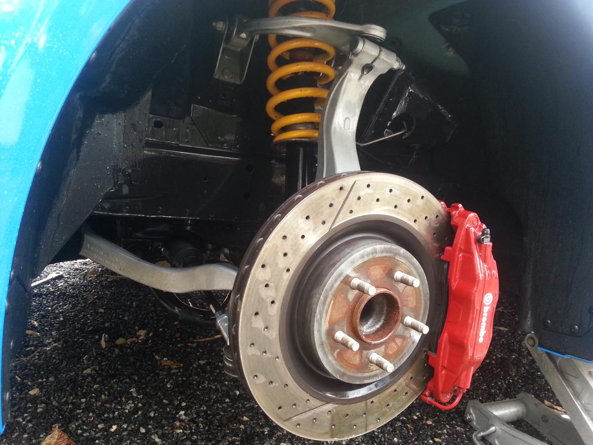

Great success on my BFII!
The key to fitting rear springs is slowly jacking, as per diagram below showing resultant strut extension.
Here's the rest of the relevant pics from over in my build thread
Pics of stock set up to remind myself of how the top sits for later
Rear suspension:
By the way don't let the brake lines get tight. I'm holding the caliper in this pic and it is not as tight as it may appear (that's what she said).
