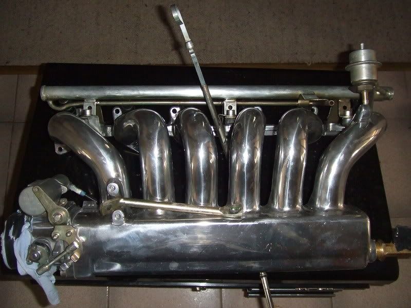

macka'sxr6t Member 1,480 Member For: 22y 4m 8d Location: Mildura Posted 29/12/07 01:12 PM Author Posted 29/12/07 01:12 PM (edited) thanks Mika, The litle sh*te has just walked in and showed me where he's stored his pics so I"'m uploading some now. We'll post more tomorrow of the engine bay ja has'nt taken any since I completed some more work todayThis was the intake menifold we were going to run but there was going to to much work involved moving A/C compressor so we elected to keep stock plenum. I little dissapointing really would have finished engine bay off nicely Edited 29/12/07 01:17 PM by macka'sxr6t

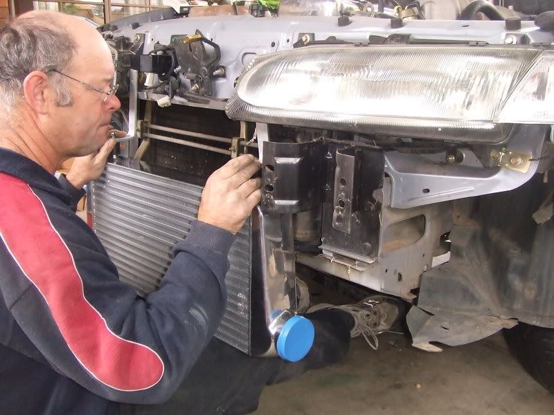

macka'sxr6t Member 1,480 Member For: 22y 4m 8d Location: Mildura Posted 29/12/07 01:27 PM Author Posted 29/12/07 01:27 PM (edited) Here's one of some bald headed old fart fitting IC and one of the engine bay before I made the IC plumping Edited 29/12/07 01:38 PM by macka'sxr6t
