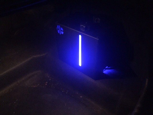

Ok. Mofos, I've finished the install. I just need a tune now. I only have water in it for now. Will buy some methanol Monday then take it to tuner. Aquamist is a complicated install and I'm yet to do the failsafes, that it even more complicated.
I'm not sure about running it before I take it to my tuner, even though I'm on a lean tune right now and it may benefit from the water on full boost. My tuner said my current tune is too lean, so it may actually be safer with the water on.
I'll do a write up on a different thread on the install. But here is a teaser:
Yes I have some tidying up to do but it is getting there.
Sent from my iPad using Tapatalk HD

That looks great mate
I personally would not worry about the meth if your using it for protection purposes only.
Can't wait to see the results.
Wiring looks very complicated though
