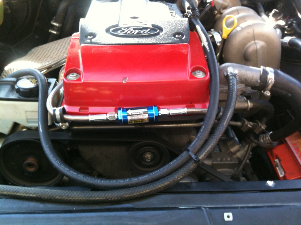

#275
Just had mine done by Pit Lane yesterday.. Better be safe than sorry. I have heard from a few places that taking it out altogether is fine too, but I chose to have a filter.

#277
:stupid:

#278
I wouldn't bother. The oil goes through the main oil filter just before it reaches the oil sender/feed line
Sadly you are wrong, I did my oil change on monday and inspected my earl filter to find it had caught 3 or 4 small particles of metal that would have ended up in my turbo.
Please guys, If you have one fitted let people know what you find as opinions like these will ruin someones turbo.
Not having a go at you, Just thought you should know.

#279
I fitted my earls kit as soon as I got the car [ like the day after I got the car] I tookout the factory plastic and gause filter body out .
#280
was thinking it was a waste but stories like these makes me think I did the right thing by fitting one.
