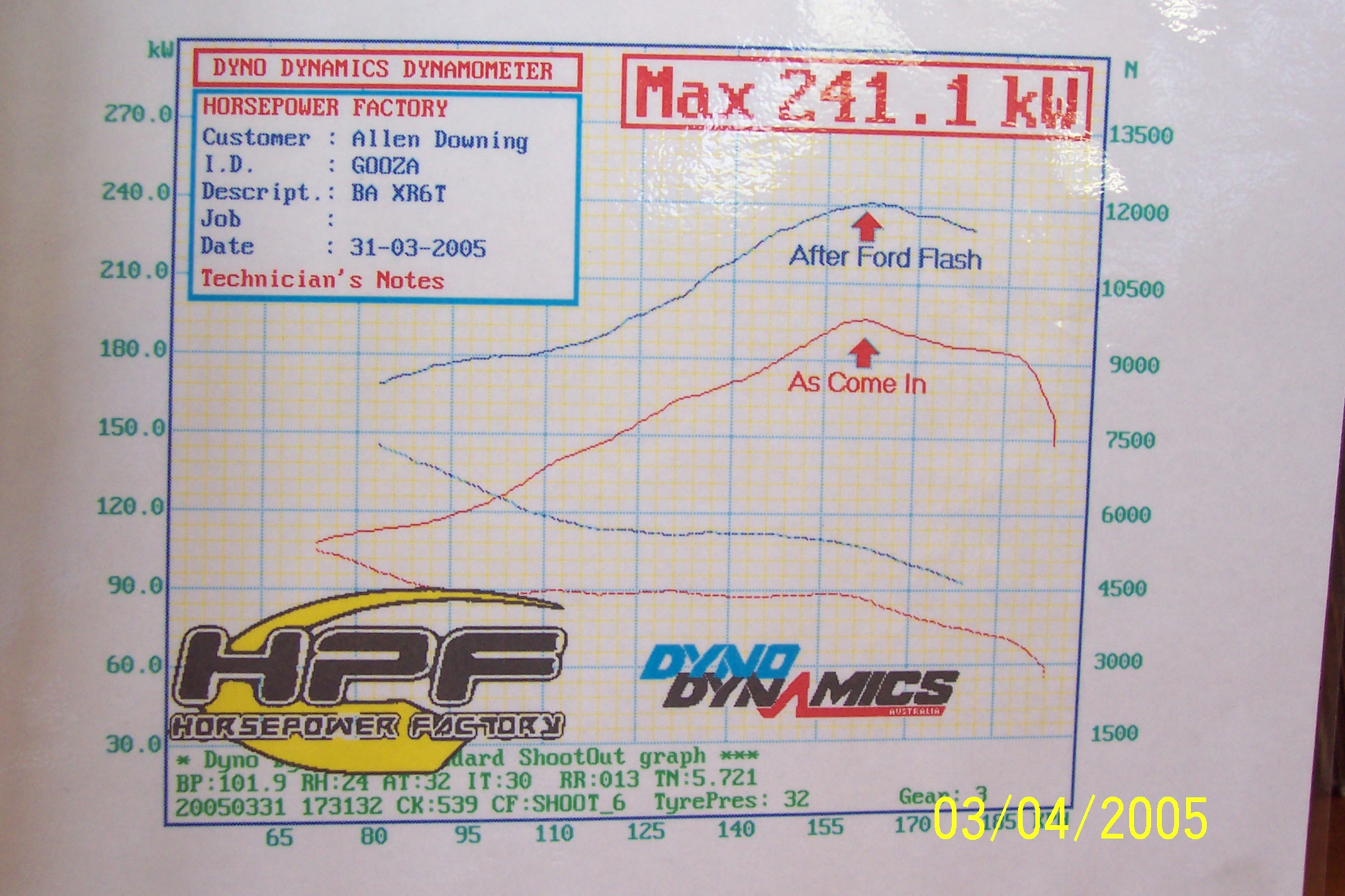

Oops, scanned image of my Graph has dropped both Left and Right Hand Axis Measurements.
KW on left, and Torque on right.
Kw went from 195 to 241.1. Torque from 450 to about 550.
I will take a photo with the Digital Camera and post it, including the scales :blush:

Heres a crappy digital photo of the Dyno Graph. :blush:

Disregard the N reading on your chart.
Torque [lb-ft] = (HP x 5250)/RPM
So, peak power is 320hp at roughly 5200rpm?
320 x 5250 = 1680000
1680000/5200 = 323 lb-ft
323 lb-ft = 438Nm @ 5200 rpm
That won't be your peak torque though. That's your torque at peak hp. Do the calculation at 3000rpm, and see what you get.
