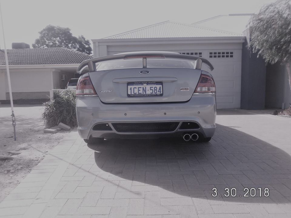

Aardvark74 Member 53 Member For: 8y 5m 25d Gender: Male Location: Perth Posted 17/04/18 04:34 AM Author Posted 17/04/18 04:34 AM On 3/26/2018 at 3:08 PM, Aardvark74 said: Just purchased a Mk1 BF Typhoon on Petroleum grey and while she is definitely a nice car and drives well. 1

arronm Dropping a turd Legacy Donating Member 9,520 Member For: 18y 10m 22d Gender: Male Location: Perth Posted 17/04/18 03:28 PM Posted 17/04/18 03:28 PM Is your car silver?
Aardvark74 Member 53 Member For: 8y 5m 25d Gender: Male Location: Perth Posted 17/04/18 05:46 PM Author Posted 17/04/18 05:46 PM Nah, Petroleum grey...just black and white pics 17 hours ago, arronm said: Have you got it checked out yet. Could be blocked cat, stuck open wastegate. boost leak.... If you are close to me I could have a quick look. Yeah mate , Im in cloverdale....Love you to come around sometime and have a look...give me some advice...this is a real project (although slowly) for me over the next few years.
arronm Dropping a turd Legacy Donating Member 9,520 Member For: 18y 10m 22d Gender: Male Location: Perth Posted 17/04/18 08:00 PM Posted 17/04/18 08:00 PM Are you sure, that's an FG colour. Whats the paint code... Is it M7 or GR. Petroleum is FG = PE 9 hours ago, Aardvark74 said: Nah the bearings were rooted in the turbo..Got a new one from Turbotech and she runs fine now..I will be getting her serviced soon though just to see if anything else needs doing asap. Did it die from lack of oil. Was the oil line blocked. Did they remove the filter in the turbo line If this wasn't checked your new turbo won't last a week. You need to call and ask some questions
Aardvark74 Member 53 Member For: 8y 5m 25d Gender: Male Location: Perth Posted 18/04/18 02:06 AM Author Posted 18/04/18 02:06 AM Damn! You're scaring me lol. When I took it in, they said it was the core...and had noisy bearings.. they did a new oil fees pipe also and gasket manifold and gasket set...Bill told me to always make sure when I get it serviced to check the oil line, but he did say the job worked out great and it was all good...if that means anything.. Oh its Dark grey in Colour...It was advertised as petroleum grey, but Im damned if I know the paint codes...Its like a gunmetal metallic? Ill check the paint code
arronm Dropping a turd Legacy Donating Member 9,520 Member For: 18y 10m 22d Gender: Male Location: Perth Posted 18/04/18 02:39 AM Posted 18/04/18 02:39 AM (edited) Better ask turbo tech did they remove turbo filter or fit a new one. If not , you better get that sort immediately.. Colour will be M7 "mercury silver" most likely.. Do you have the log books.. Edited 18/04/18 02:41 AM by arronm
Aardvark74 Member 53 Member For: 8y 5m 25d Gender: Male Location: Perth Posted 18/04/18 03:11 AM Author Posted 18/04/18 03:11 AM Yep Mercury silver...haha "Petroleum grey" lol I like the colour though and the dark agents look good on it...gonna ring turbo tech right now...no log books..the car had done less than 300 km in 2 years...still has the service sticker for 2016 on the window...runs nice though No, he didnt understand what I was asking.Their job is to replace the turbo and do the oil etc..the rest is up to me...told me to ring Monster torque
