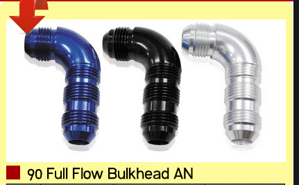

Ralph Wiggum Moar Powar Babeh Lifetime Members 19,332 Member For: 19y 9m Gender: Male Location: Perth Posted 22/05/14 01:18 AM Author Share Posted 22/05/14 01:18 AM Unfortunately the ORBS swivels are still too tall. I took a couple of MM off the Boss but it still fouls. I can't take anymore off as the fitting will foul on the end plug and I'll run out of thread to secure the fittings.So back to square one and doing what I was trying to avoid. I have retapped the M14x1.5 thread to 9/16 UNF (same size thread as the Flare end of -6 AN fitting)I will use 2 of these -6 Full Flow AN bulkhead fittingsCut off the second and last thread, thread the fitting into the rail and the TIG it to the rail. This give me the tightest bend for clearance between the plenum and rail and still a full flow fitting. Link to comment https://www.fordxr6turbo.com/forum/topic/88279-nizpro-plenum-and-plazaman-fuel-rail/page/3/#findComment-1473080 Share on other sites More sharing options...
