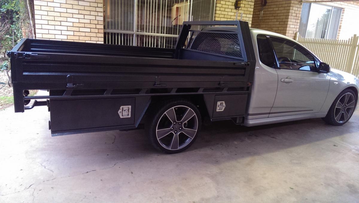

bupalooga Silver Donating Members 262 Member For: 12y 8m 25d Gender: Male Location: Griffith NSW Posted 04/05/14 09:14 AM Author Share Posted 04/05/14 09:14 AM Figured I'd best post the tray I ended up with. Got it done by SJR Industries in Griffith NSW which I'm very happy with.Its 2.4m long, Had them make it as long as possible without interfering with the extended tow bar. 2 rear under body boxes, driver side front box & 2m under tray Drawer. Due to some height constraints (or lack of height) with their usual prefabricated pipe headboards, we went with 75x50 RHS for the ladder racks. This also made the headboard mesh turn out better with the design that I wanted. The Rear ladder rack is designed so it can be removed & slotted in against the front rack, both have removable rack pins. The side boards have a sort of double V fold design to them they had just started using. The sides can all be lowered and removed independently of each without making the adjacent one sit loosely by using the small rear posts that the ladder rack slots into and an extra clamp in each rear corner. Those posts come out when you want to make it a flat deck. I picked out some big break/indicator lights that just fit and used a pair of work light style lights as reversing lights. (I hate reversing) The towbar had a sh*tty paint job so I had them powder coat it along with the tray Aztec Silver.So yea it hasn't had and heavy use yet but its dam solid with no rattles. Went back with my toolboxes and installed some nutserts to bolt them down too. Link to comment https://www.fordxr6turbo.com/forum/topic/87707-fg-ute-tray-suggestions-input-wanted/#findComment-1469344 Share on other sites More sharing options...
Gussa Donating Members 220 Member For: 14y 4m 27d Gender: Male Location: Gippsland Posted 04/05/14 09:26 AM Share Posted 04/05/14 09:26 AM Looks good bud. Link to comment https://www.fordxr6turbo.com/forum/topic/87707-fg-ute-tray-suggestions-input-wanted/#findComment-1469349 Share on other sites More sharing options...
