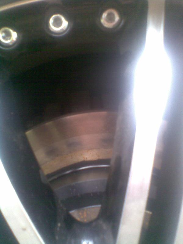

jas98 Member 1,046 Member For: 12y 9m 13d Gender: Male Location: Maryborough Qld Posted 10/04/13 05:29 AM Share Posted 10/04/13 05:29 AM (edited) Hi replaced all disks and greased up claipers etc everything was moveing freely anyway the rear hub nut came loose on teh left the other day, I have a woop woop woop sound from teh reari have noticed this (pic) but it looked fine last weekcould it be a bent calaiper? loose caliper?or just normal? pads are QFM brand new and bearings are brand new also no play in wheeljust looks like only half the pads contacting the disk, please note, the bottom area about half a center meter above where the black paint is im aware that's not supposed to be touched by the pad, im just worried how its 2 tone colouralso been about 1200klm since I did brakes, othersides fine Edited 10/04/13 05:31 AM by jas98 Link to comment https://www.fordxr6turbo.com/forum/topic/84574-is-this-normal-rear-disk-pic/ Share on other sites More sharing options...
Rootster Just a large member member Silver Donating Members 3,125 Member For: 16y 6m 19d Gender: Male Location: sydney Posted 10/04/13 06:49 AM Share Posted 10/04/13 06:49 AM whats the other side of the disk look like Link to comment https://www.fordxr6turbo.com/forum/topic/84574-is-this-normal-rear-disk-pic/#findComment-1379355 Share on other sites More sharing options...
jas98 Member 1,046 Member For: 12y 9m 13d Gender: Male Location: Maryborough Qld Posted 10/04/13 01:52 PM Author Share Posted 10/04/13 01:52 PM good point, im ripping it apart tommorow to see, will post up picsbut yeah, any idea wtf? like I know how sometimes pads do wear differently but ive never seen thisunless its in teh disk itself but I doubt Link to comment https://www.fordxr6turbo.com/forum/topic/84574-is-this-normal-rear-disk-pic/#findComment-1379488 Share on other sites More sharing options...
Pazzo Donating Members 11,132 Member For: 14y 6m 14d Gender: Male Posted 10/04/13 08:02 PM Share Posted 10/04/13 08:02 PM If its a ute........ Could be bent axle.. That's if it's a ute of course. Link to comment https://www.fordxr6turbo.com/forum/topic/84574-is-this-normal-rear-disk-pic/#findComment-1379506 Share on other sites More sharing options...
boost69 Donating Members 737 Member For: 19y 11m 17d Posted 10/04/13 11:41 PM Share Posted 10/04/13 11:41 PM If the pads are still new, it might take a bit of time for them to start making proper even contact.Though if your wheel nuts were loose, that could have meant your rotor was contacting the pad unevenly as you were driving.Was the "woosh woosh" stopping when you were applying the brakes? Link to comment https://www.fordxr6turbo.com/forum/topic/84574-is-this-normal-rear-disk-pic/#findComment-1379533 Share on other sites More sharing options...
ms700 Moderating Team 10,170 Member For: 22y 3m 4d Gender: Male Location: Sydney Posted 11/04/13 12:24 AM Share Posted 11/04/13 12:24 AM id say the woosh noise is the famed handbrake horseshoe rubbing on the inside of the drum/disc noise. Link to comment https://www.fordxr6turbo.com/forum/topic/84574-is-this-normal-rear-disk-pic/#findComment-1379553 Share on other sites More sharing options...
jas98 Member 1,046 Member For: 12y 9m 13d Gender: Male Location: Maryborough Qld Posted 11/04/13 04:20 AM Author Share Posted 11/04/13 04:20 AM its more of a woop woop woop then a wooosh. its a sedanalso seems to stay the same when applieing the brakes, sometime alittle louderits more noise then anything, also tried applieing handbrake slightly while driveing but still there Link to comment https://www.fordxr6turbo.com/forum/topic/84574-is-this-normal-rear-disk-pic/#findComment-1379630 Share on other sites More sharing options...
Rootster Just a large member member Silver Donating Members 3,125 Member For: 16y 6m 19d Gender: Male Location: sydney Posted 11/04/13 05:54 AM Share Posted 11/04/13 05:54 AM I have to say to me it sounding more like a rear wheel bearing and hub assembly..I changed mine a couple of weeks ago, my rear end at low speed was making all sorts of noises...For some reason the rear hub assemblies are made of soft metal I pressed it on only turning the wheel on the press..Mine was the L/h rear and the cv shaft was completely dry I think ford forgot to put lube on it..Covered in some sort of rusty dust.. Link to comment https://www.fordxr6turbo.com/forum/topic/84574-is-this-normal-rear-disk-pic/#findComment-1379647 Share on other sites More sharing options...
