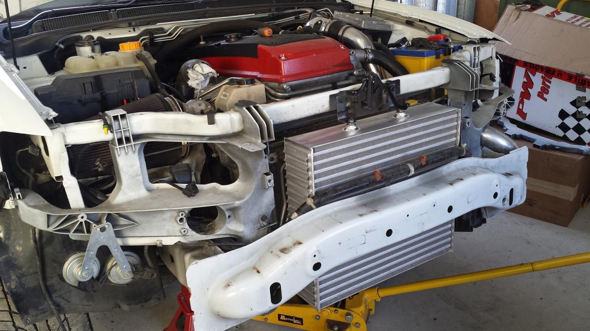

Stigmata Donating Members 235 Member For: 12y 3m 25d Gender: Male Posted 18/06/14 10:59 AM Author Share Posted 18/06/14 10:59 AM Hey GuysI hope everyone has been well. Sorry for the delay in getting the rest of the G6 done. Ok so I finally got a chance to get her into the workshop and start on the new cooler. The core is a lightweight Euro tube n fin, its massive!! The core is has 490 tube length and will end up being 5" or 125mm thick with tanks. It has been a very tight squeeze to get it in to where it sits at moment. I will start folding the sheet tanks tomorrow, I did stay back for a bit tonight and tried a few temps out made from card. Anyway here's a few pics of where it sits at present. I will post more as the build goes along, then its of to the dyno again next weekKindest regards Jon Link to comment https://www.fordxr6turbo.com/forum/topic/83988-g6et-first-tune/page/19/#findComment-1479364 Share on other sites More sharing options...

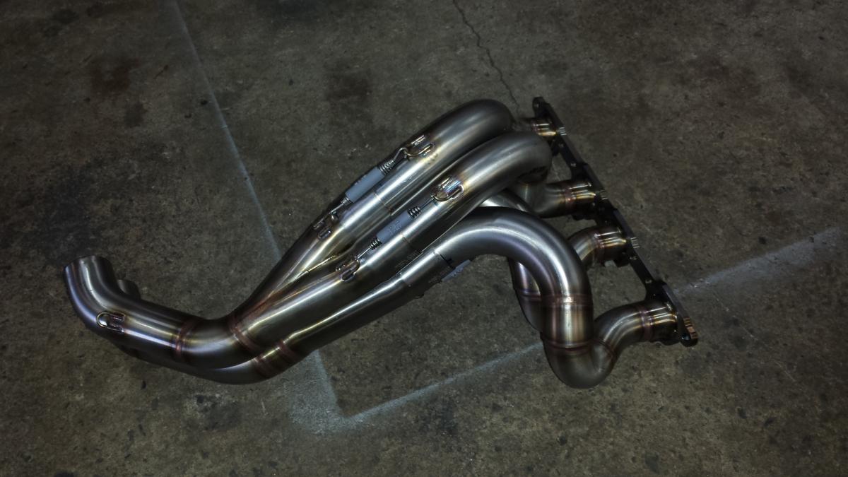

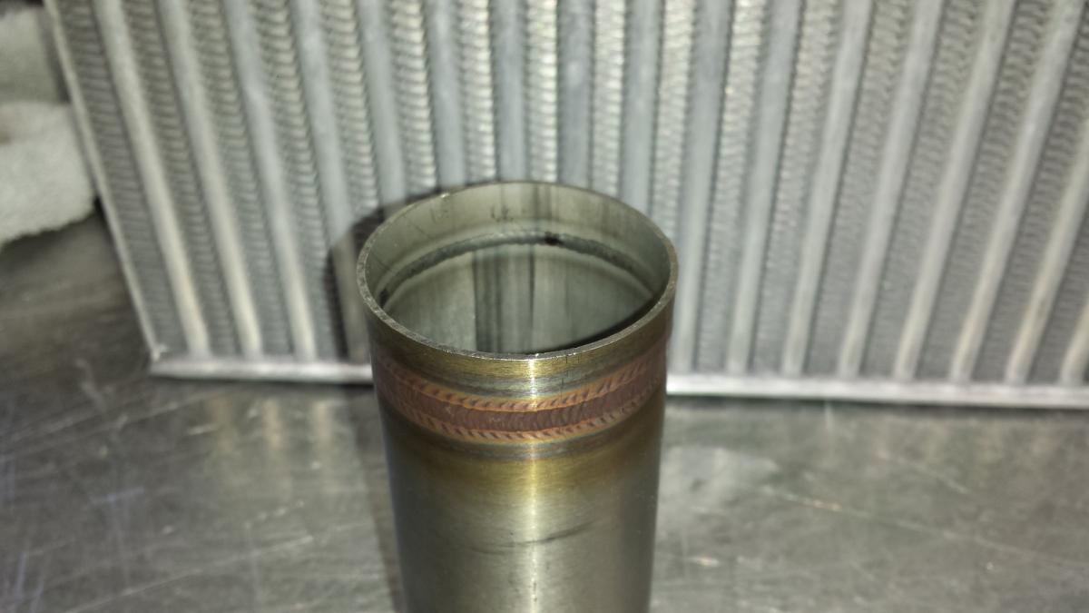

Stigmata Donating Members 235 Member For: 12y 3m 25d Gender: Male Posted 18/06/14 11:26 AM Author Share Posted 18/06/14 11:26 AM Here's some pics of header pipes I just built for a TRD trophie truck if anyone's interested. 321 SS 30thou wall 3 step tuned tri-y. Something a bit different. Attached a pic showing the purged weld too...Kindest regards Jon 1 Link to comment https://www.fordxr6turbo.com/forum/topic/83988-g6et-first-tune/page/19/#findComment-1479376 Share on other sites More sharing options...
