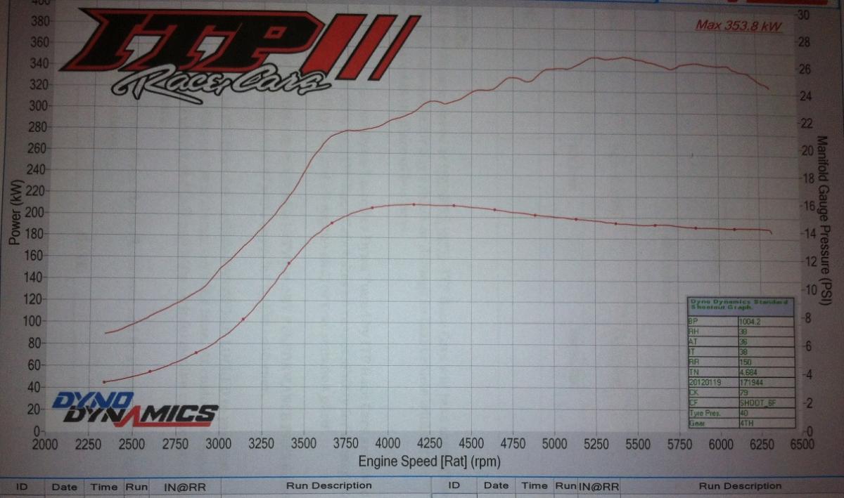

IH8TOADS Silver Donating Members 3,618 Member For: 19y 11m 3d Gender: Male Location: OZ Posted 19/05/12 07:28 AM Share Posted 19/05/12 07:28 AM Here's a dyno sheet and corresponding datalog using Livelink of a Rapid Cooler in quite hot temps. 36+ in the dyno room this day and the IAT were hitting 43 degrees C at the end of the run. Decel they were peaking at 46 degrees C (115 F).The last pic is of a 395kw BF with a nizpro cooler doing a 3rd gear run on the street and then holding the RPM at ~ 6000rpm (drifting). This was on a much cooler day around 22 degrees.Both coolers appear to be working quite well. As you can see by the nizpro cooler (and applies to most).....if you stay at high rpm the IAT's do start creeping! 1 Link to comment https://www.fordxr6turbo.com/forum/topic/80174-rapid-v30-kit/page/5/#findComment-1239801 Share on other sites More sharing options...

ratter Member 6,793 Member For: 19y 15d Gender: Male Location: @ my laptop Posted 23/05/12 12:06 AM Share Posted 23/05/12 12:06 AM Thanks, that the sort of info I see on my dyno as well, it's a bit different to what others posted earlier in the thread and if you used live link it would actually show a bit higher due to the quicker sampling rate etc Link to comment https://www.fordxr6turbo.com/forum/topic/80174-rapid-v30-kit/page/5/#findComment-1241623 Share on other sites More sharing options...
