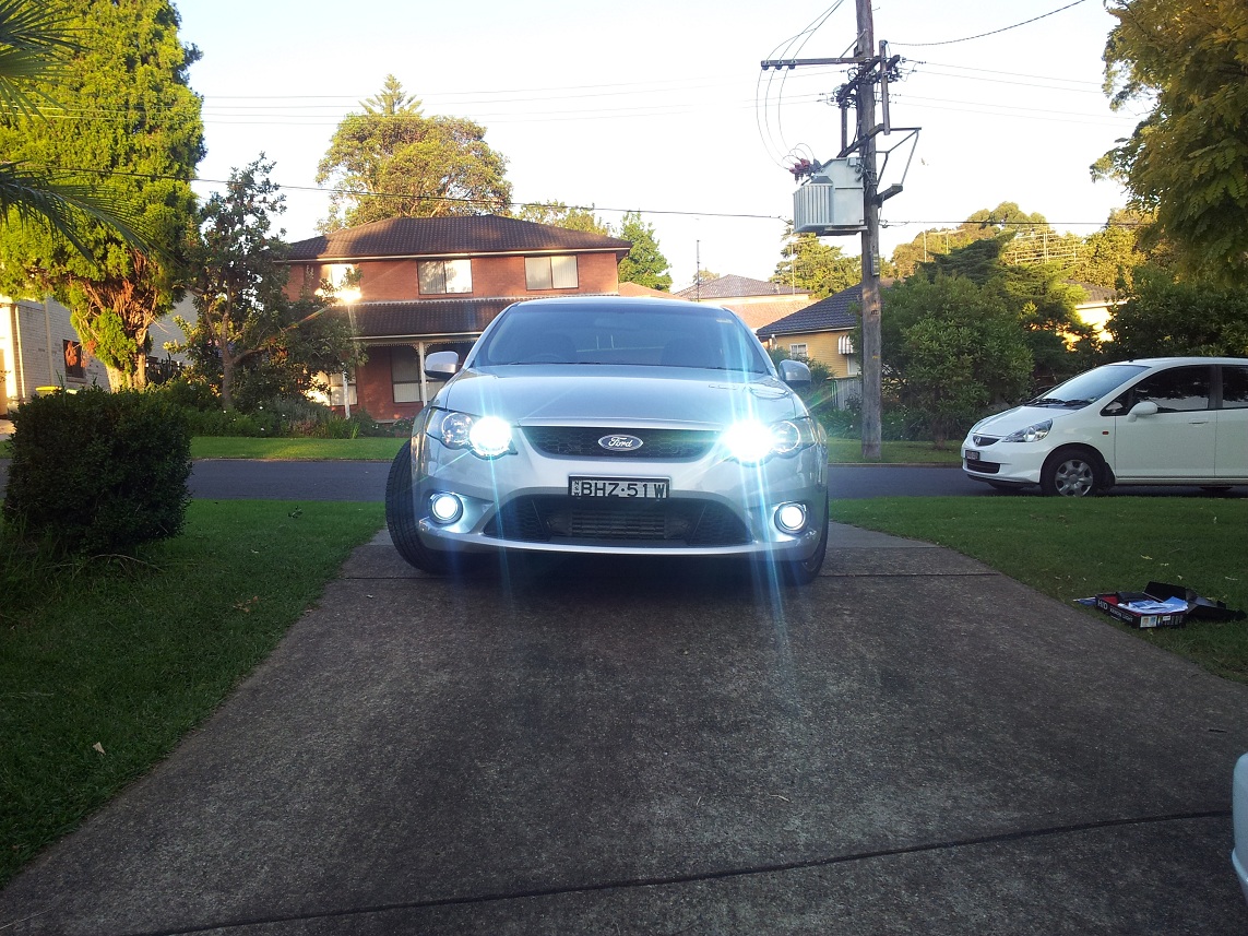

Goliath Member 383 Member For: 14y 10m 21d Gender: Male Location: Sydney Posted 23/02/12 09:18 AM Share Posted 23/02/12 09:18 AM (edited) Kit arrive at work today. Installed the h4's and h11's when I got home.Had a couple of issues installing them- The power cable connected to the left H4 was a bugger to get off and whilst attempting to pull it off, the ring and clip that holds the light in came off. Managed to get it back in after some fiddling around. Had to stick a flat head screw driver between the pins and the connector and use it as a wedge to disconnect them.- Left H11 was a bastard to get in, purely because of the water bottle stored there.- Broke a clip of each H11 trying to get them in. They still hold in firmly, so not to fussed about itJust used double sided tape to mount the H11 ballast in the front bar, have not yet mounted the H4 ballast, but only tucked them in behind the light. Will look in to a more secure fitting soon haha.Also realised one of my parkers was out, have news ones on the way as well as Phillips Diamond Vision H7's.Added a few pics of the kit and install. Note I took of the airbox off, this is not neccessary, but I had to due to the stubborn connector. Tried to take some more pics now, but the lights are giving me to much glare on the phone camera. Edited 23/02/12 09:22 AM by Goliath Link to comment https://www.fordxr6turbo.com/forum/topic/78823-hid-lights/page/27/#findComment-1200656 Share on other sites More sharing options...
bossmang FREAKY Donating Members 12,440 Member For: 15y 5m 11d Gender: Male Location: Melbourne Posted 23/02/12 09:38 AM Share Posted 23/02/12 09:38 AM they look good mate, what K temperture did you go with?did you have trouble getting the clips off the back of the globes because they have a little button thing on them you have to press first! Link to comment https://www.fordxr6turbo.com/forum/topic/78823-hid-lights/page/27/#findComment-1200661 Share on other sites More sharing options...
TRA1NR Pitlane Member Donating Members 2,886 Member For: 18y 1m 4d Gender: Male Location: Pakenham, Victoria Posted 23/02/12 10:02 AM Share Posted 23/02/12 10:02 AM Looks good mate, my h4's were an absolute pain to get off as well! I mounted my ballasts horizontally on the metal bar behind the headlight. I used Velcro for the h11 ballasts, they haven't got too far to fall anyway! And I also took my battery and airbox out but it was necessary for the h7's. Link to comment https://www.fordxr6turbo.com/forum/topic/78823-hid-lights/page/27/#findComment-1200673 Share on other sites More sharing options...
Shyfrd Turboless Donating Members 5,992 Member For: 14y 3m 9d Gender: Male Location: Geelong, Victoria Posted 23/02/12 10:28 AM Share Posted 23/02/12 10:28 AM very nice on the silver colour! looks the goods mate Link to comment https://www.fordxr6turbo.com/forum/topic/78823-hid-lights/page/27/#findComment-1200685 Share on other sites More sharing options...
Goliath Member 383 Member For: 14y 10m 21d Gender: Male Location: Sydney Posted 23/02/12 11:02 AM Share Posted 23/02/12 11:02 AM they look good mate, what K temperture did you go with?did you have trouble getting the clips off the back of the globes because they have a little button thing on them you have to press first!Went with the 6000k for both. Fogs seem to have more blue in them. Don't think the H4 have clips on them? the drivers side one came out no worries.very nice on the silver colour! looks the goods mate Thanks a lot mate. Will have to check the allignment some time tonight to make sure I don't blind to many people, haha. Link to comment https://www.fordxr6turbo.com/forum/topic/78823-hid-lights/page/27/#findComment-1200698 Share on other sites More sharing options...

MiKa Donating Members 4,243 Member For: 18y 9m 15d Gender: Male Location: Melbourne, VIC Posted 23/02/12 11:38 PM Share Posted 23/02/12 11:38 PM Maybe because the in the headlights it 'bounces' around more before it projects out? where as the fog lights its more direct? I dunno just a guess..Looks good Goliath, as the others have said suits the colour of the car great..Cant wait to get my fogs done.. Link to comment https://www.fordxr6turbo.com/forum/topic/78823-hid-lights/page/27/#findComment-1200874 Share on other sites More sharing options...
