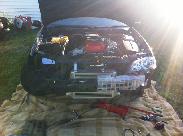

I thought I would share my new intercooler and install with everyone. I went with an AVO kit, not the usual I know but I like to do things a little differently sometimes and not go with the 'norm'
My thoughts on this kit are that its a nice well thought out kit although is a bit of a pain to fit, alot of fiddling around and trimming of some metal here and there.
At the moment im half way through fitting it and have some photos to share. I think I will pull the cooler out tomorrow and do some more trimming as im not 100% happy with how it fits currently.
I will post more photos as more is done

Looks like its comin along pretty nicely dude, where abouts do you have to do the trimming?

Had to trim the Reinforcement bar so the end tanks cleared. Because of the thickness (90mm) of the core it was a super tight fit.
I will upload the rest of the photos tonight, as its all finished.
I have to say I like the kit now its on, it looks better than what I thought it was going to. And driving it...I now have that nice deep turbo flutter lol.

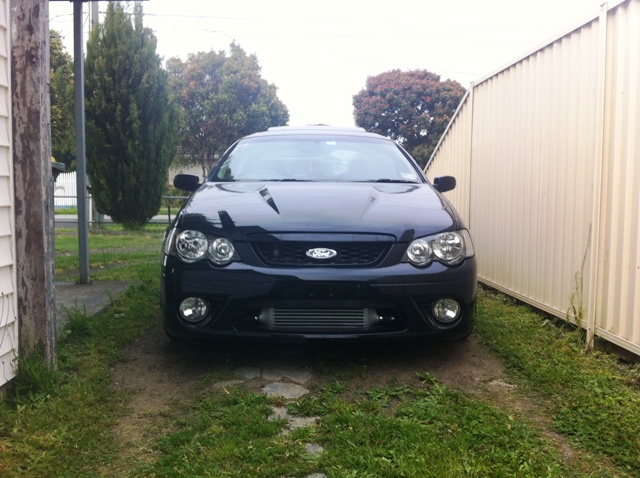

Ok finished up today....I was happy with how it turned out

Geeez have't seen one of them for a while, cooler looks good but.

They actually sell the coolers in Stealth black but I asked them to powder coat one for me in silver, and im glad I did. I got it powder coated even though everyone told me to leave it black.
The red crossover pipes are one of those love it or hate it type things, I dont mind them now.
