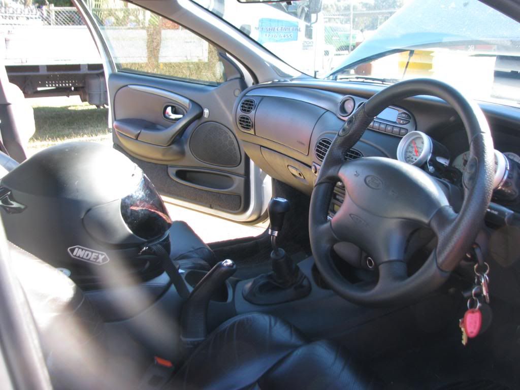

For those that dont know the car, its an AU TS50, Kenne Bell supercharged 5.0L Modular engine, T-56 manual trans with PPG dogbox and a 35 spline 9" rear end. Car is daily driven on BP98 but ran E85 for the meet making over 700 wheel horsepower.
60'....1.64
660'... 6.59 @ 110.78
1/4..... 10.11 @ 140.23
Car was awesome pulling 10.30-10.50 In Friday testing then grabbed this time with the first pass on Saturday morning in better track conditions... Came around to run my 9 and it slipped the clutch all through first and proceeded to weld the metal clutch solid... Weekend over.
There is a stack of potential left in the car as it runs a tall 28 x 9" tyre and 3.25 rear ratio meaning it was crossing the line in 3rd gear at 7000rpm... Going to build a 3.9 rear centre and use 4th gear which will see the 60' times drop into the 1.5's and the 9 second pass will be there for the taking.
