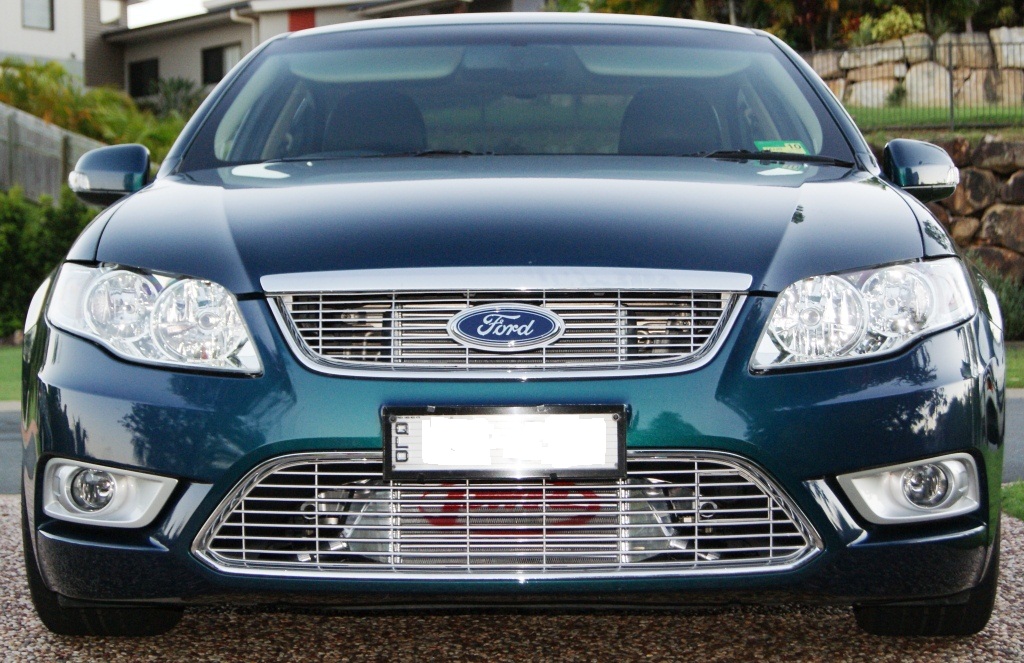

Johnny G Team Grandpa Qualified Legacy Donating Member 809 Member For: 21y 7m 23d Gender: Male Location: Brisbane North. Posted 23/01/11 03:25 AM Posted 23/01/11 03:25 AM So instead of shovelling mud in the Lord Mayors army yesterday, I had a day off and installed some bling on the BowlsMobile. Nice result;
Henz Tampon inserted, Auto Acquired, next purchase a new handbag Legacy Donating Member 9,946 Member For: 18y 6m 16d Gender: Male Location: Vic Posted 23/01/11 03:33 AM Posted 23/01/11 03:33 AM Never realized those coolers were so tall!Looks good.

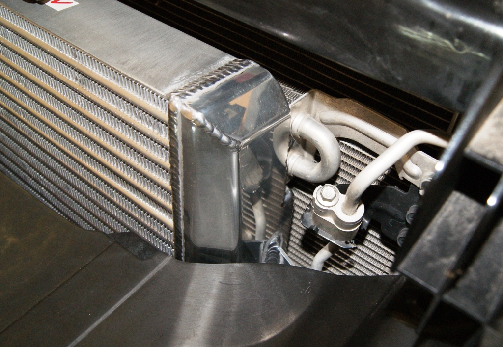

Johnny G Team Grandpa Qualified Legacy Donating Member 809 Member For: 21y 7m 23d Gender: Male Location: Brisbane North. Posted 23/01/11 03:42 AM Author Posted 23/01/11 03:42 AM Tall and deep - had to remove the foam pad from the undertray to get it back on! And the top goes all the way to the top - there aint no more room. And first time I think I've done a mod where I didn't cut/shove/push/move/destroy something to get it right. It fitted like a finger in a ____. Oh - and PS; had to spin the calibra clamps around facing backward as the thread stems were too long for the tray as well(see pic). Wasn't that such fun to have to pull the front off again (note to self - check clearances you nong).

tuono Member 312 Member For: 15y 10m 23d Posted 24/01/11 02:53 AM Posted 24/01/11 02:53 AM that's a monster! Looks awesome. V8 owners will crap there pants seeing that coming up in the rear view. Performance results?
MexicanBatman G666E Turbo!!! Member 1,008 Member For: 16y 8m 20d Gender: Male Posted 24/01/11 12:34 PM Posted 24/01/11 12:34 PM Same as mine but different, I haven't got the red writing on mine..Seems the goods, but the look funny from an angle..... Kinda like it's not on straight cos of the angle of the tanks... But a good upgrade... What pipes??? I have the herrod pipes.... Not to all they are a great price but the clamps are poo, so factor in another $20 for better hose clamps.. Although they do do the job... But I'm fussy..
