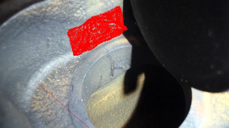

Ralph Wiggum Moar Powar Babeh Legacy Donating Member 19,334 Member For: 21y 4d Gender: Male Location: Perth Posted 30/11/11 11:21 PM Posted 30/11/11 11:21 PM Anyone come accross the larger flapper catching on the port and the way around it ?You need too mill a small amount of material out of the side wall of the housing(red area) and also ensure you dont take too much material (how much is too much,.....???) out of the top of the port (as marked with red lin in picture) the port should resemble a "D" with the flat side of the "D" being the ares uner the swing valve pivot.Dont forget too open up the throat of the port from inside the housing and make sure you blend the edges of the port inside and out too prevent cracking (it will still crack eventually but no need to encourage it!). i normally create a channel inside the housing to help direct the waste gas through the port.There some good info here about porting and blending the inside of the exhaust housing. Pics/story relate to a Mazda Miata/MX5 but you'll get the idea. I dont tend too go as deep with the channel but I do make it wider and make it widen out too the full width of the exhuats inlet port towards the bottom.http://www.bellengin...articles_id=273Oh and thanks for the Pic 1600Dave!
arronm Dropping a turd Legacy Donating Member 9,520 Member For: 18y 11m Gender: Male Location: Perth Posted 01/12/11 12:31 AM Posted 01/12/11 12:31 AM (edited) bump what is the size of the hole stock and what are people porting them out to??? is 30mm enough???STD flapper is 33mm and hole is 26mm. So if the new flapper is 37mm then I suppose the new hole will be about 33mm.26mm area = 530.92mm233mm area = 855.29mm2 Edited 01/12/11 12:37 AM by arronm
Ralph Wiggum Moar Powar Babeh Legacy Donating Member 19,334 Member For: 21y 4d Gender: Male Location: Perth Posted 01/12/11 01:19 AM Posted 01/12/11 01:19 AM ^ There isnt really an answer too "what size are people porting them out too" The hole isnt round when finished, as mention it should be a D shape. As I mentioned earlier in the thread, I usually leave aprox 1.5mm over lap.As Aronn mentioned the oold flapper is 33m, with this overlap the "round" section of the new port is aprox the same diameter as the old flapper valve. But the squared off section reduces the overall area. Porting and blending the inside of the exhaust side helps overcome size increase lost too this area.

JVK Legacy Donating Member 751 Member For: 20y 9m 9d Gender: Male Location: North West Hot Hell,VIC Posted 01/12/11 12:38 PM Posted 01/12/11 12:38 PM Thanks for the info Luke ,I didnt Quite do the D shape as such but did open up the port considerly and the associated blend work but was worried about the flap catching on the edge of the port due to the way I had opened it up (before the flap was tigged) so I ended up putting a slight chamfer on the outer edge of the flapper face just for that extra bit of clearance when it returns shut.Maybe not the best solution but it works fine.I did also relieve the chamber in the area you marked in your pic.I guess on my next one I will pay a little more attention Lol.
