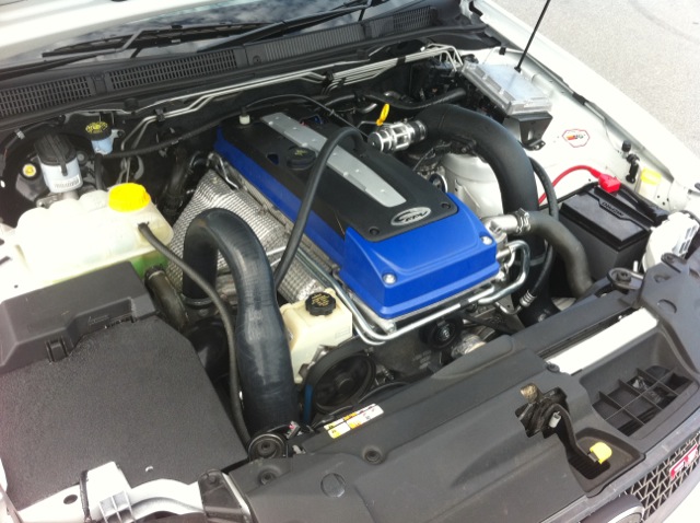

Roof Member 213 Member For: 16y 8m 22d Gender: Male Location: Perth | Busselton Posted 06/10/10 09:37 AM Author Share Posted 06/10/10 09:37 AM (edited) Pic 1 Edited 06/10/10 09:47 AM by Roof Link to comment https://www.fordxr6turbo.com/forum/topic/70921-359rwkw-fg-f6-manual-sedan/#findComment-1045591 Share on other sites More sharing options...

Kv! Donating Members 1,132 Member For: 15y 3m 9d Gender: Male Location: Eastern Suburbs, Melbourne Posted 07/10/10 01:09 AM Share Posted 07/10/10 01:09 AM Nice one mate, bet it's a weapon now !Good to see some safety precautions you have got there.I didn't know nizpro had a airbox/battery relocation for the Fg, how much are they, if you don't mind me asking? Link to comment https://www.fordxr6turbo.com/forum/topic/70921-359rwkw-fg-f6-manual-sedan/#findComment-1045729 Share on other sites More sharing options...

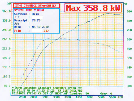

Roof Member 213 Member For: 16y 8m 22d Gender: Male Location: Perth | Busselton Posted 07/10/10 10:58 AM Author Share Posted 07/10/10 10:58 AM Dyno Link to comment https://www.fordxr6turbo.com/forum/topic/70921-359rwkw-fg-f6-manual-sedan/#findComment-1045898 Share on other sites More sharing options...
