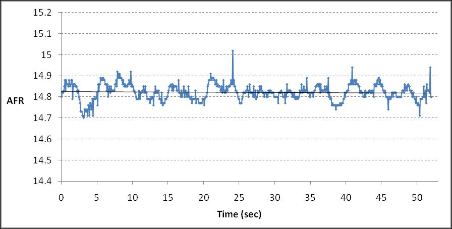

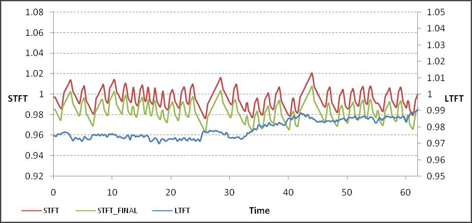

IH8TOADS Legacy Donating Member 3,618 Member For: 21y 2m 18d Gender: Male Location: OZ Posted 07/10/09 01:58 AM Posted 07/10/09 01:58 AM Here's an example where logging is handy for tuners. I'm about to fit a PW surge tank and 044 as my AFR's start leaning regardless of what I command in the base fuel table (I'm assuming the walbro intank needs some help, hence the surge/044). See attached "AFR run" Since I have modified the fuel system I need to adjust my base fuel table and will also try new injector scalars and then fine tune them for my car. I don't really need to use a dyno as I can log fuel trims with the xcal2 (and then adjust my scalars to suit the new fuel system) and tune the base fuel table with my AFR logger. My previous nizpro scalars used a minimum pulse width that was similar to factory yet with a bigger injector you should really drop the minimum pulse width...in theory. So I have adjusted the scalars based on this principal. My fuel economy hasn't been the best with the Nizpro injectors (comapared to dekas) so im exploring reasons for this also. You can see in the graphs that the long term fuel trim (LTFT) tells me my low slope is a little fat. I.e. the PCM is cleaning up fueling (pulling ut a bit of fuel) to achieve the AFR you see at idle ~14.82In short data logging is awesome if you can use the data, whether to pass onto your tuner for analysis or to tune yourself.

plasmid2 Member 45 Member For: 18y 3m 18d Posted 08/10/09 09:38 AM Author Posted 08/10/09 09:38 AM As I am also new to this. Can you explain what the first graph means?Difference between LTFT and STFT. Cheers.
