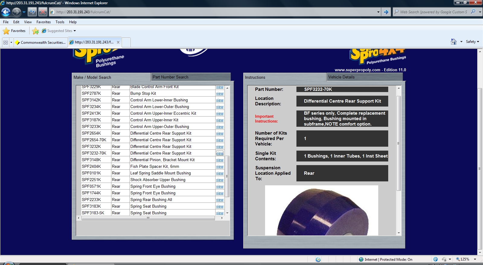

Guest STEVE_BAXR Guests Posted 10/09/09 10:40 AM Share Posted 10/09/09 10:40 AM Any one know if the new version of the Superpro diff bush for a BF is available yet? Is it part #SPF3232K?that is the old bush part number Link to comment https://www.fordxr6turbo.com/forum/topic/59908-nolathane-diff-bush-noise-fix/page/6/#findComment-931518 Share on other sites More sharing options...
eblis New Member 9 Member For: 20y 9m 10d Posted 10/09/09 09:07 PM Share Posted 10/09/09 09:07 PM So is the new bush available yet? BF part #? Link to comment https://www.fordxr6turbo.com/forum/topic/59908-nolathane-diff-bush-noise-fix/page/6/#findComment-931654 Share on other sites More sharing options...
f-wolf Member 897 Member For: 18y 2m 23d Gender: Male Location: ACT Posted 11/09/09 02:47 AM Share Posted 11/09/09 02:47 AM (edited) So is the new bush available yet? BF part #?Found here: http://203.31.191.243/fulcrumCat/ Edited 11/09/09 02:52 AM by f-wolf Link to comment https://www.fordxr6turbo.com/forum/topic/59908-nolathane-diff-bush-noise-fix/page/6/#findComment-931756 Share on other sites More sharing options...
eblis New Member 9 Member For: 20y 9m 10d Posted 11/09/09 02:52 AM Share Posted 11/09/09 02:52 AM Thanks f-wolf Link to comment https://www.fordxr6turbo.com/forum/topic/59908-nolathane-diff-bush-noise-fix/page/6/#findComment-931757 Share on other sites More sharing options...
