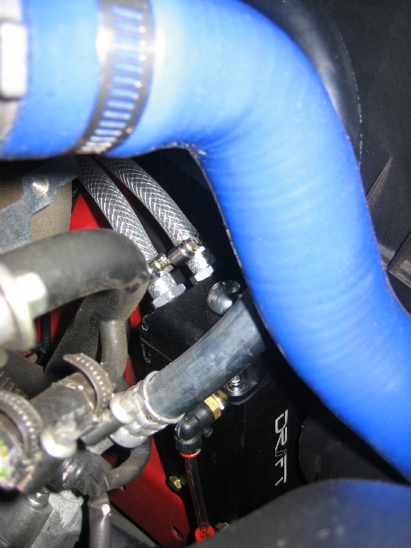

benjam Member 138 Member For: 21y 5m 15d Location: Sydney NSW Posted 06/01/07 10:38 AM Posted 06/01/07 10:38 AM Has any one fitted one of these to the stock Plumbing.←Heres where I installed my one. I think it's the same one as seventytwo mentioned, Drift spec, anyway it's a good size for where I put it next to the airbox. Check out the pics. Looks a bit more stealth than the others which I like. Ben

bjc Legacy Donating Member 2,823 Member For: 23y 15d Gender: Male Location: Townsville Posted 29/01/07 09:20 AM Posted 29/01/07 09:20 AM Well I finally fitted the $50 catch can the other night after spraying the boost solenoid. I had bought this over a year ago and couldn't find a suitable place to fit it so I decided that it was fine where it is in the pics.I used left over fuel hose to connect it to the existing line. The catch can is empty inside so I was thinking of buying one of the old metal scouring pads to put inside it to grab the oil as it enters?Anyway thought you would all be interested as a cheap option.Brett

stang Legacy Donating Member 1,353 Member For: 22y 7m 30d Location: Melbourne Posted 07/07/08 12:24 PM Posted 07/07/08 12:24 PM Problem with breathers is that you will get defected if inspected by epa or a meber of the law as you are venting to the atmosphere.Hey ben,Does it matter which hose goes in and out of the catch can?also how did you secure your catch can as there is stuff all room in there.cheers pete.
